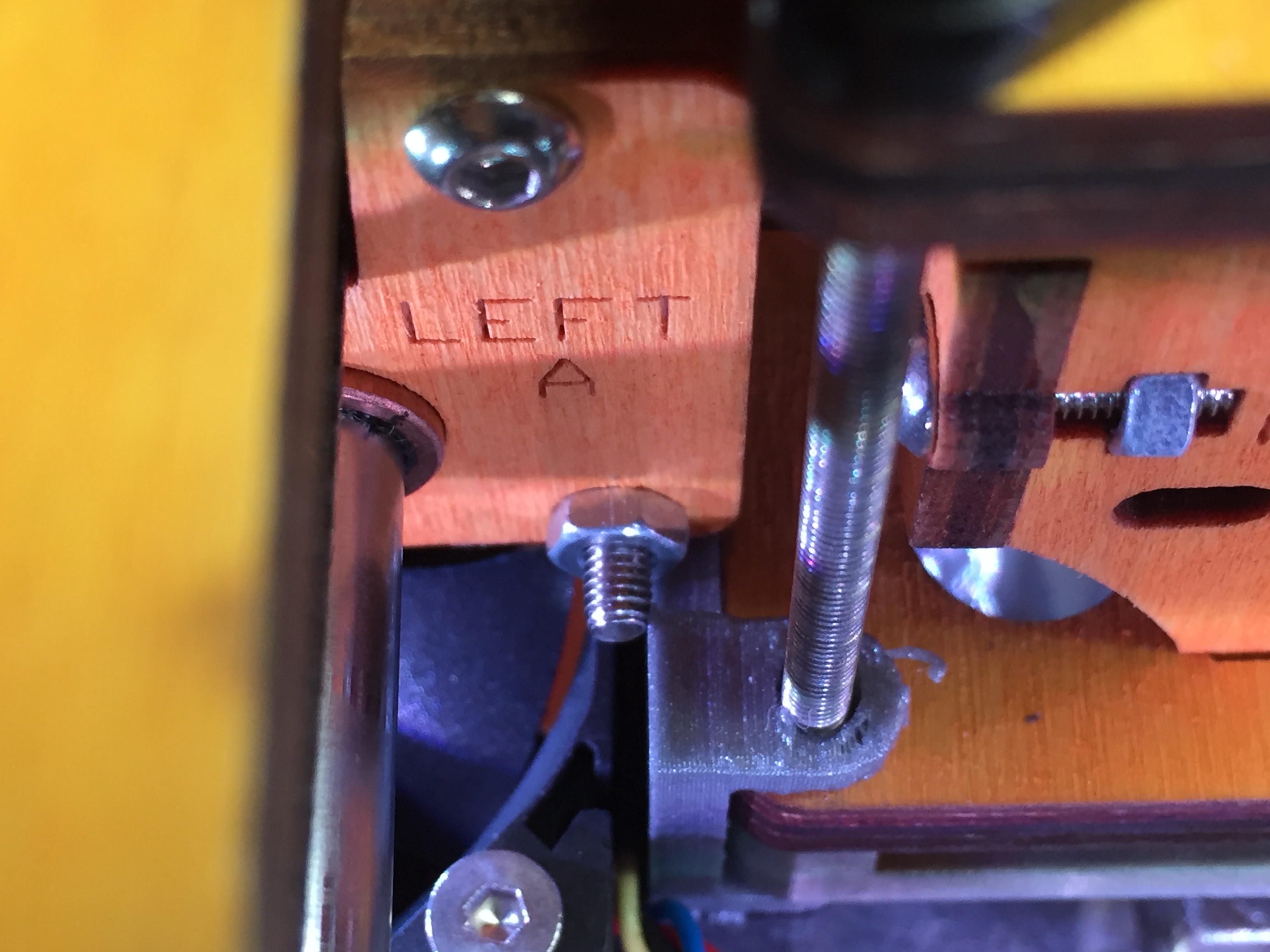

Post by LePaul » May 29th, 2016, 9:09 pm
I am still having problems homing.
lools like I need to make this screw a few threads shorter

LePaul wrote:I am still having problems homing.
Look at the picture from Titus ;)
