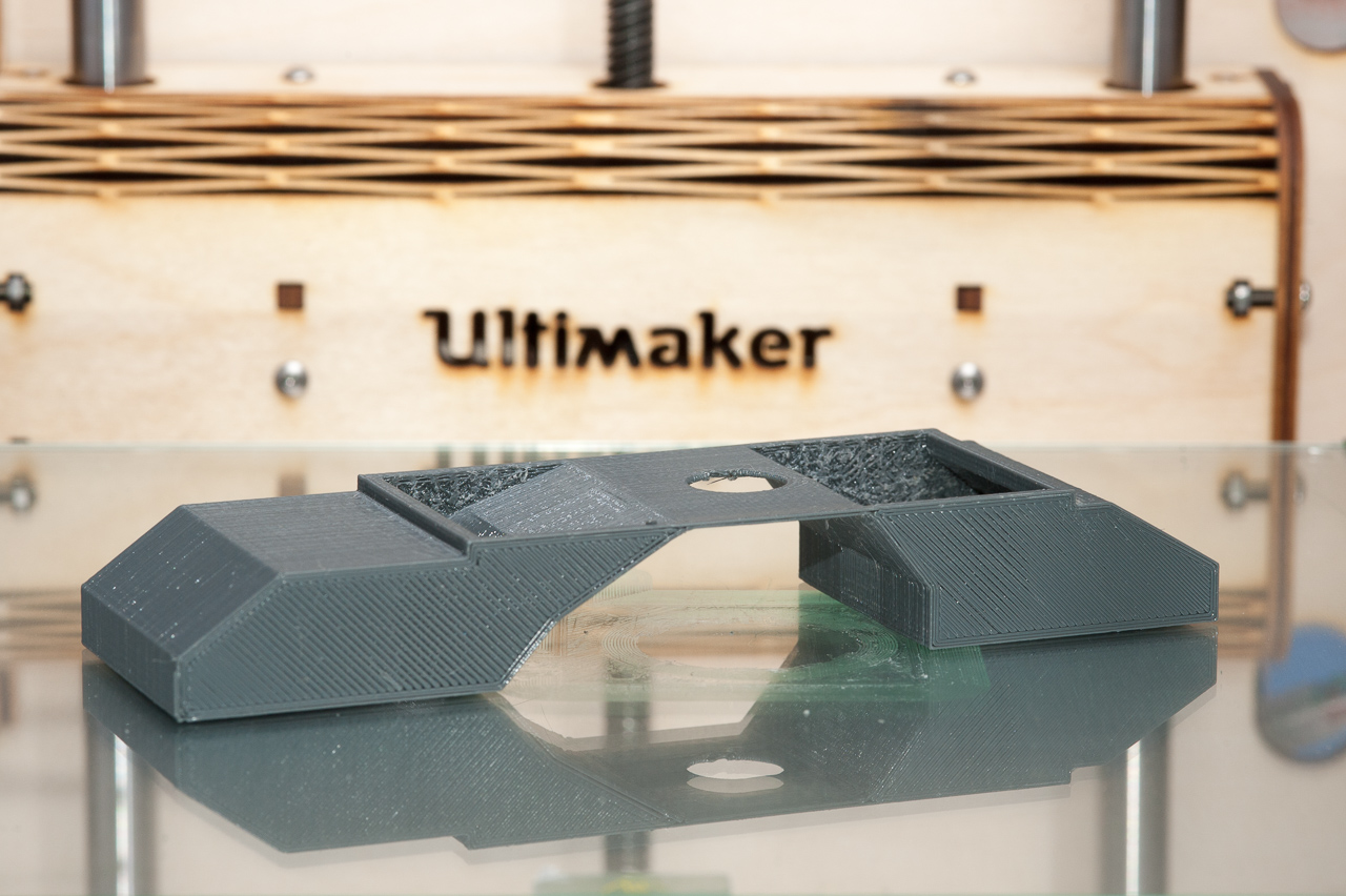

Print came OK, now it's the matter of putting everything together and see how it goes with nGen...

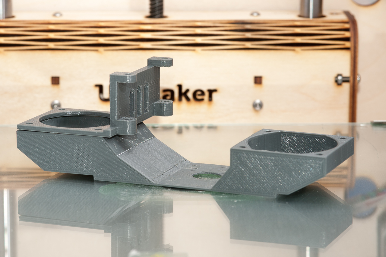

If you fell 'brave'. I just published an untested 40x40 fancap based on my just finished umo/um2 fancap.Amedee wrote:Print came OK, now it's the matter of putting everything together and see how it goes with nGen...
https://ultimaker.com/en/community/2052 ... ply-146939

Were you able to do that without fan or minimal?Amedee wrote:Print came OK, now it's the matter of putting everything together and see how it goes with nGen...
Not a bad print
