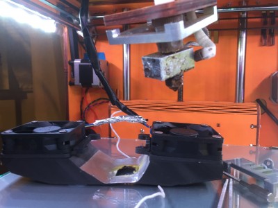

Well I have an impressively hooped up nozzle and heater block. The coupler is actually okay
But since I put the brass pipe and nozzle on too snug last year, I figured a fix might be needed. I have spare parts since I originally bought the dual extruder kit
I'm just wondering if it might be time for some upgrades? I can't remove the screw from the heater block. But I do have a replacement thermo pack (both wires/heater/sensor)
I also have the UM2 print head from the Upgrade sitting here. But that upgrade would require an expensive motherboard upgrade.
Here's where I left it. :). You can see my shroud is pretty well cooked too!
Suggestions to tweak this thing again?
