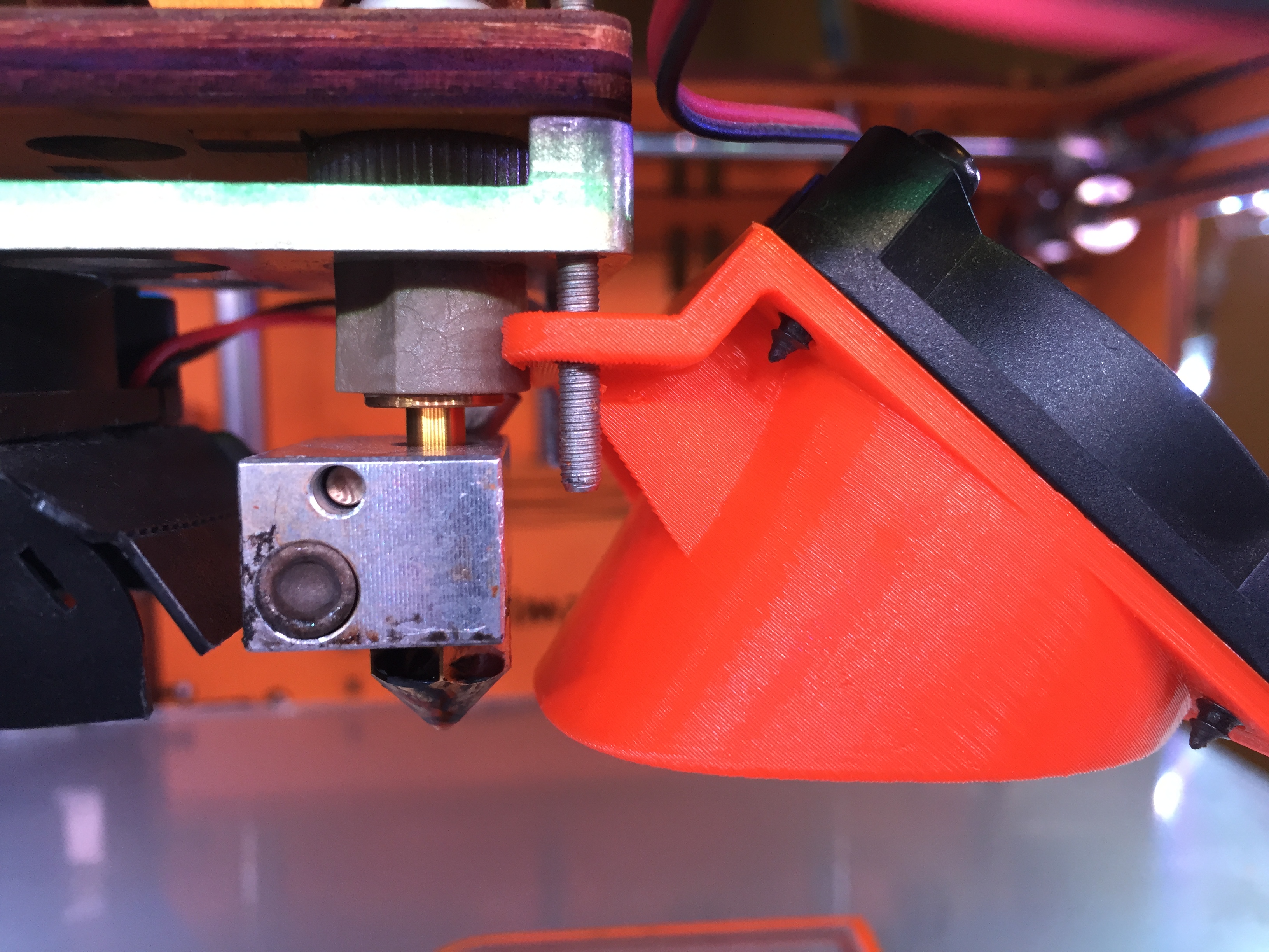

Since the addition of the heated build plate, I really noticed that prints with overhangs struggle with the airflow of fan only on one side.

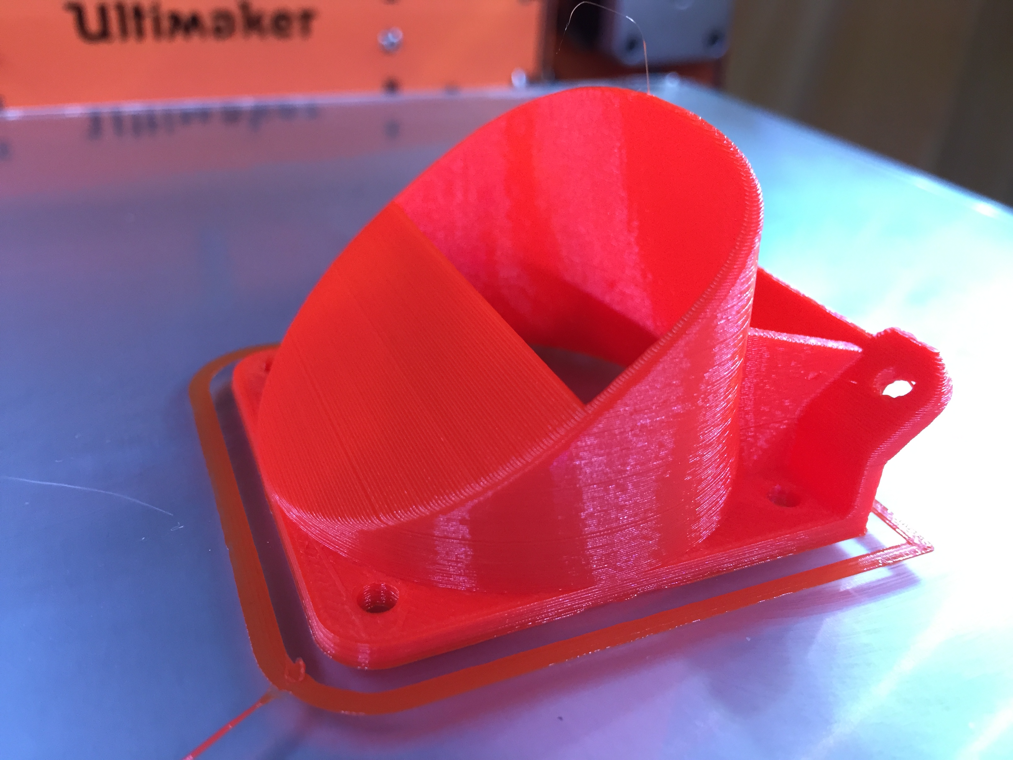

I am going to replace the duct on the original fan with this shroud: http://www.thingiverse.com/thing:69327

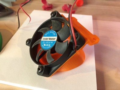

I found a fan that is identical to the one that came with the UMO (50 mm) and printed this shroud: http://www.thingiverse.com/thing:267403
I'm a little concerned where the shroud comes close to the print head...it might get soft or melt...but with air flowing through it, it might survive?

Post by Anders Olsson » February 14th, 2016, 7:14 pm
As long as there is some gap in between I think it will not melt.
It did not melt on our Delta Tower until it actually touched the nozzle at least :lol:

Will the shroud touching the ceramic piece above the head be ok?

Post by Xeno » February 15th, 2016, 2:29 am
LePaul wrote:Will the shroud touching the ceramic piece above the head be ok?
The peek is supposed to function as an isolator, so it should be fine
