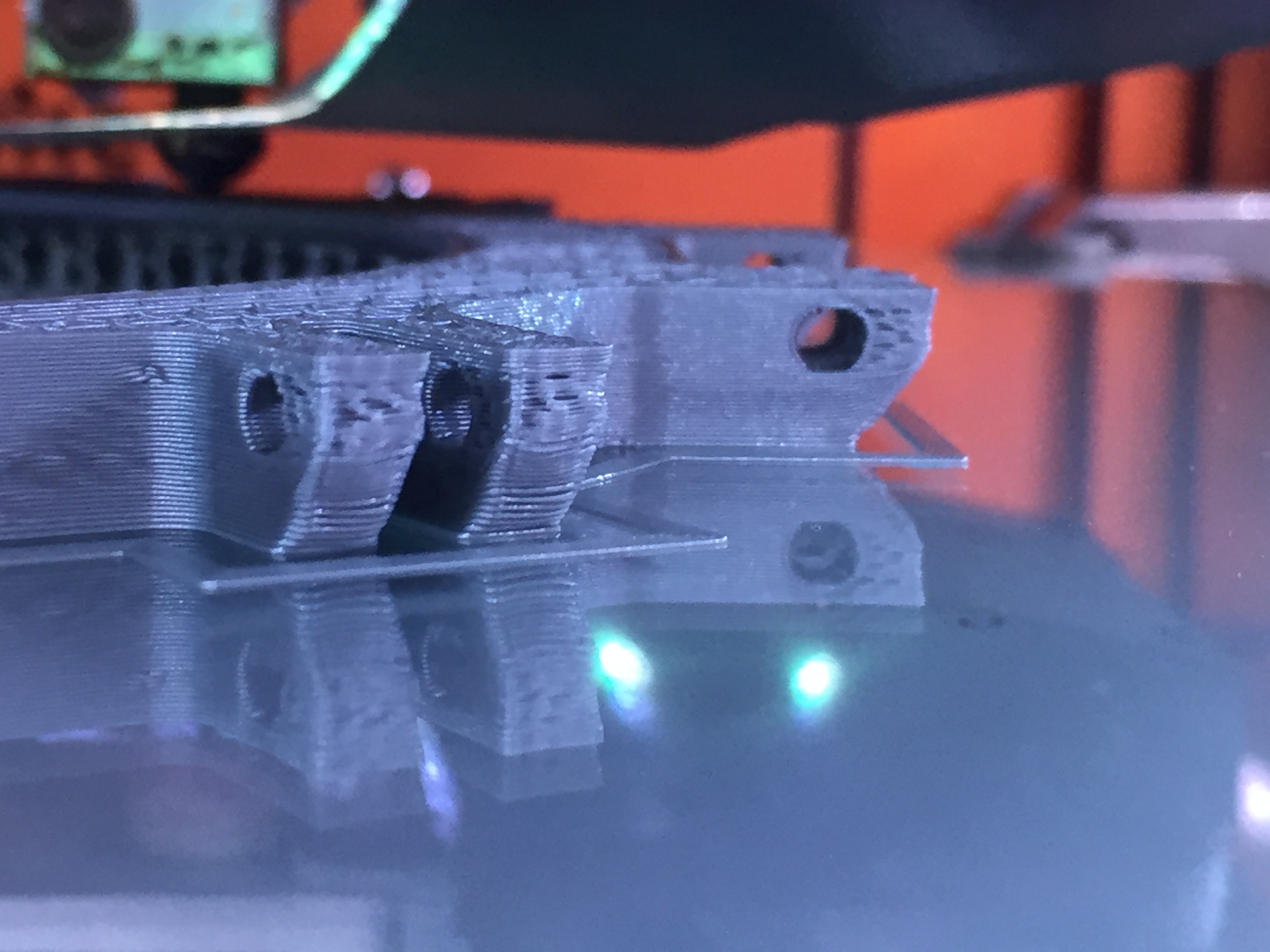

So far 50mm/sec at 210 looks ok
I upped the Travel speed to 200 and on the printer set acceleration to 30000
I'm seeing some of this....so I upped it to 215 for the remainder of the print. Thoughts?
Posts: 3329
Re: Testing for the new shroud?
Post by LePaul » July 19th, 2016, 9:31 am
Titus,
I found 45 mm/sec is a good trade off.
The next part I printed at 45 mm/sec @ 216C didn't have the above
The 50mm/sec part had a few minor blobs when I went from 215 to 220...just to see the difference.
Slower is better on a part like this :)
