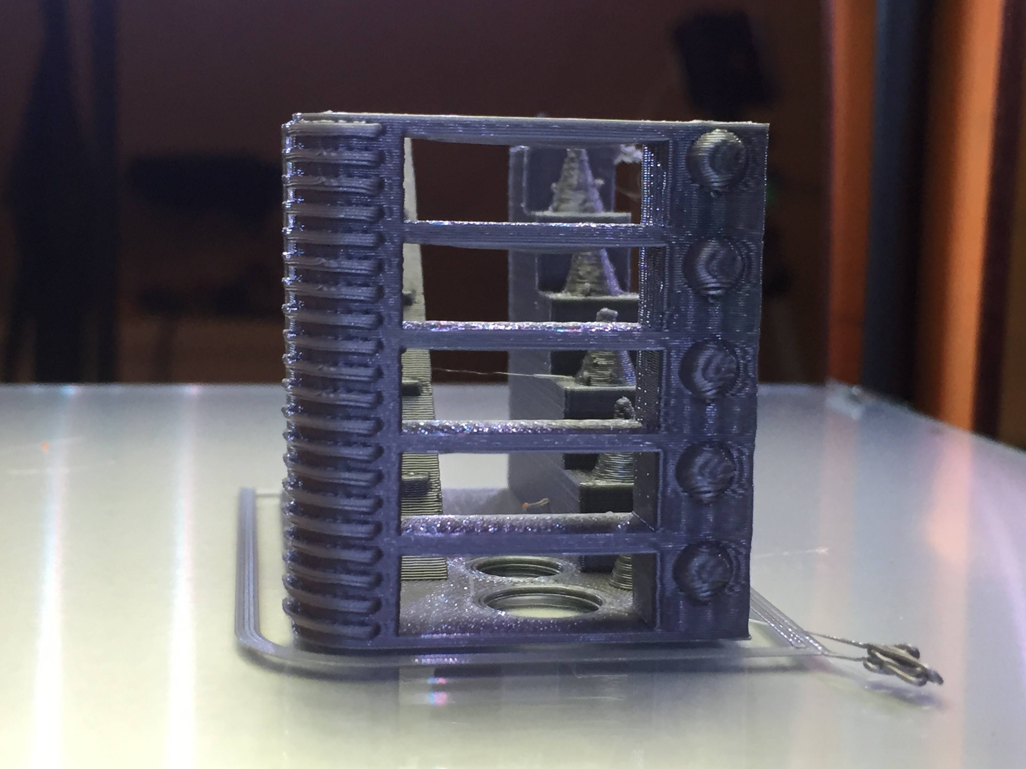

I'm going to keep the fans at 14% and give it a go
200 had me underextruding so I started at 205. Now to keep checking on it and upping the temp :)
Posts: 3405
Re: Testing for the new shroud?
Post by LePaul » July 15th, 2016, 10:07 pm
How's this temp away look? Too much? Lower fans more?
Posts: 3405
Post by LePaul » July 15th, 2016, 11:52 pm
From bottom up.... 205, 210, 215, 220, 225
40 mm/sec
14% fans
Retract speed 40, distance 4.6

It's only 4 degree swing, that's fine, could even be your sensor. If you are worried about that you can auto tune pid.
Picture looks good from 205-215 right?

Post by LePaul » July 16th, 2016, 10:03 am
What about the blobbing?

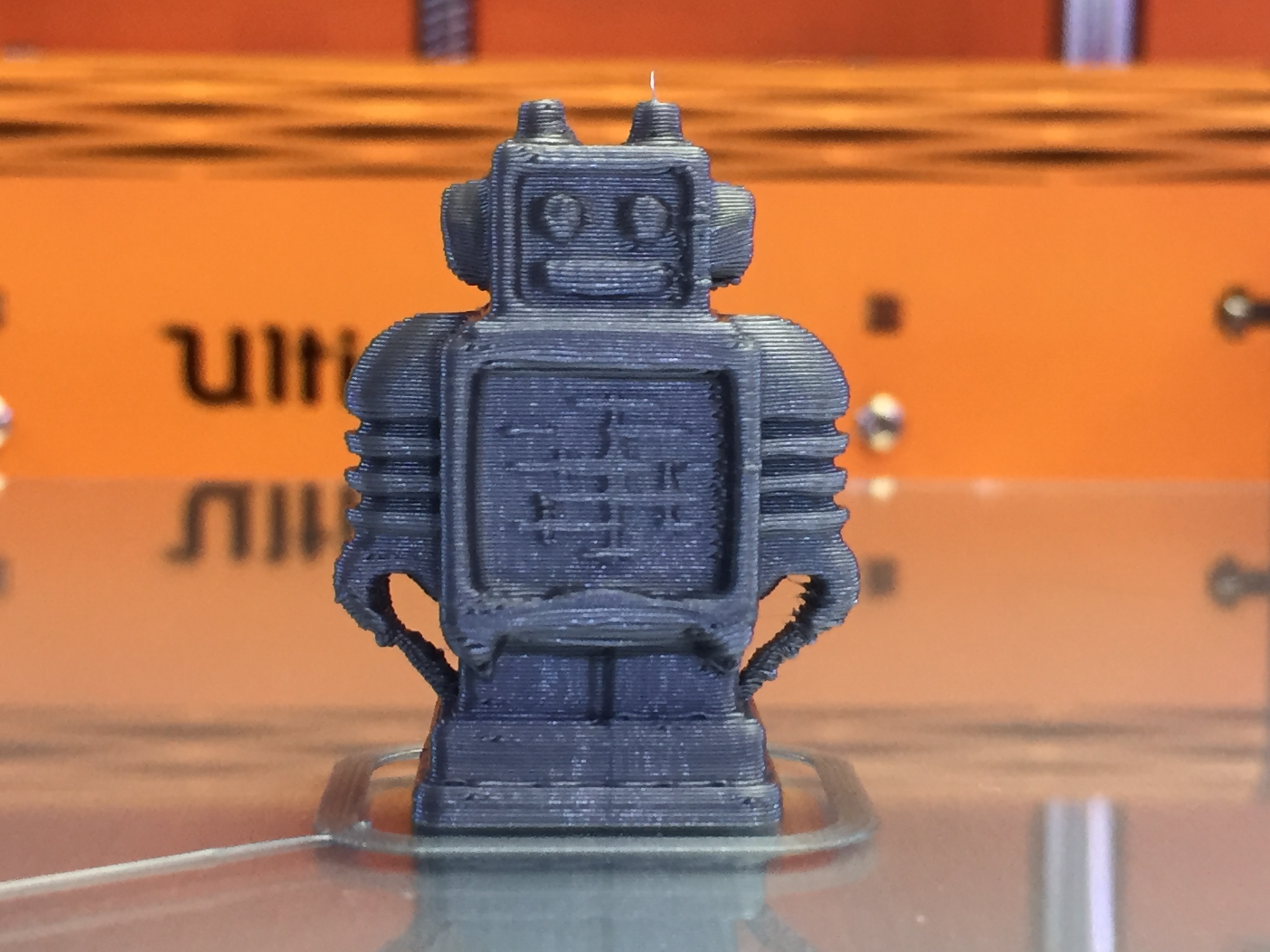

Okay let's do some Ultimaker robot test prints
Here's 210 C at 40mm/sec
Fans at 10%
