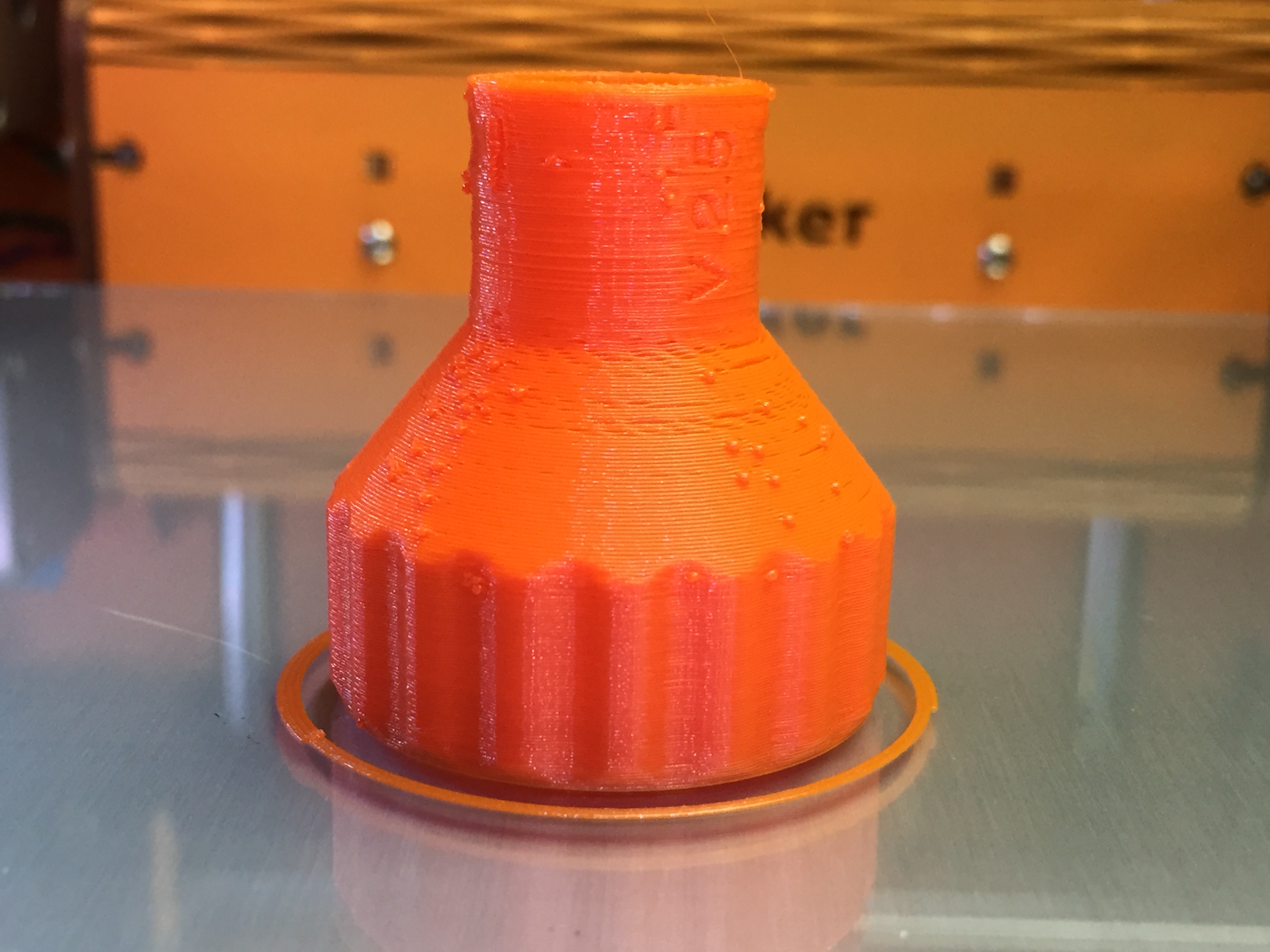

Post by LePaul » July 11th, 2016, 10:37 pm
Well no more leaning
But wow. So many blobs
235c with low fan and 45 mm/sec
nGen filament. Yikes. Looks awful

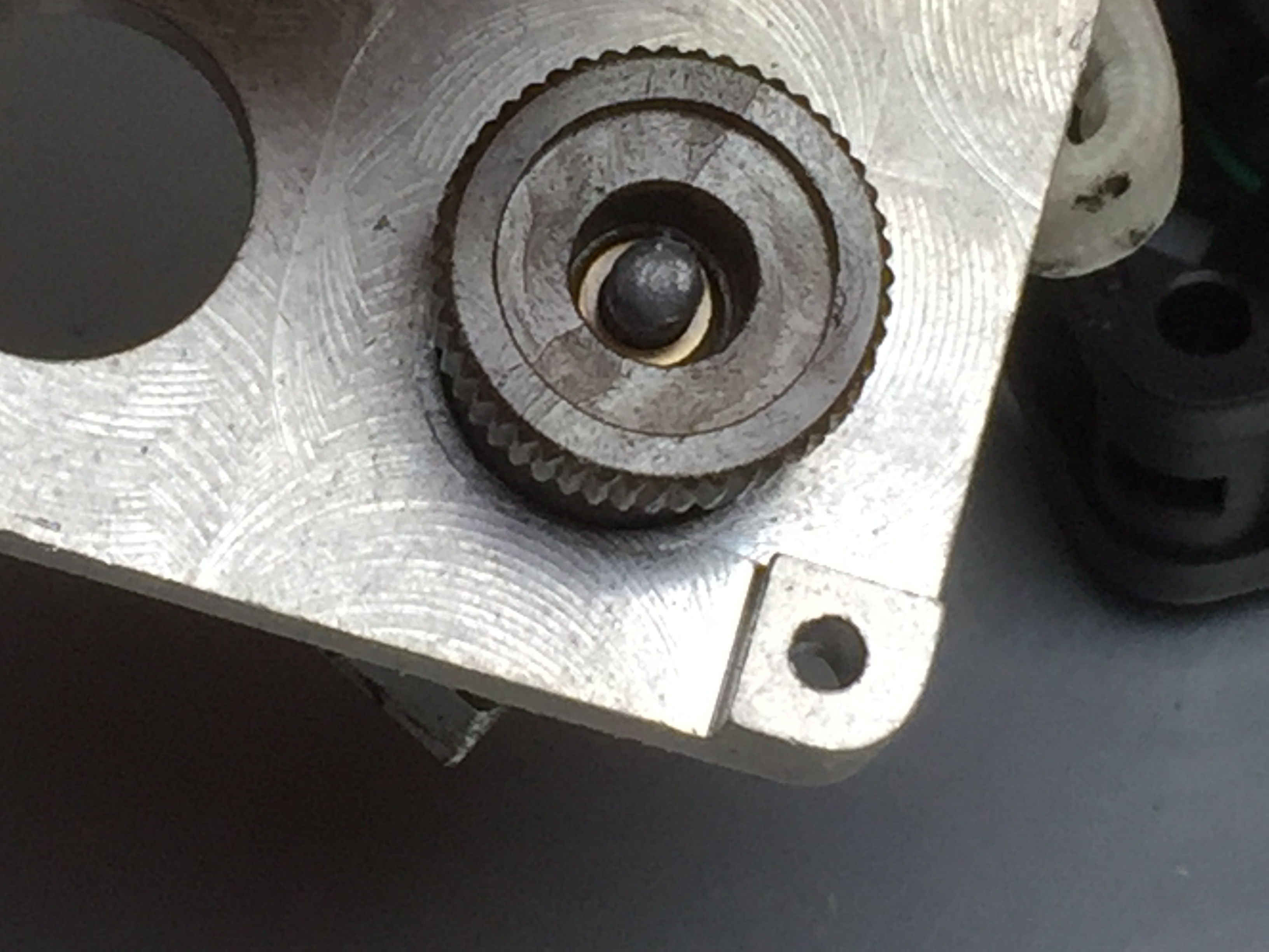

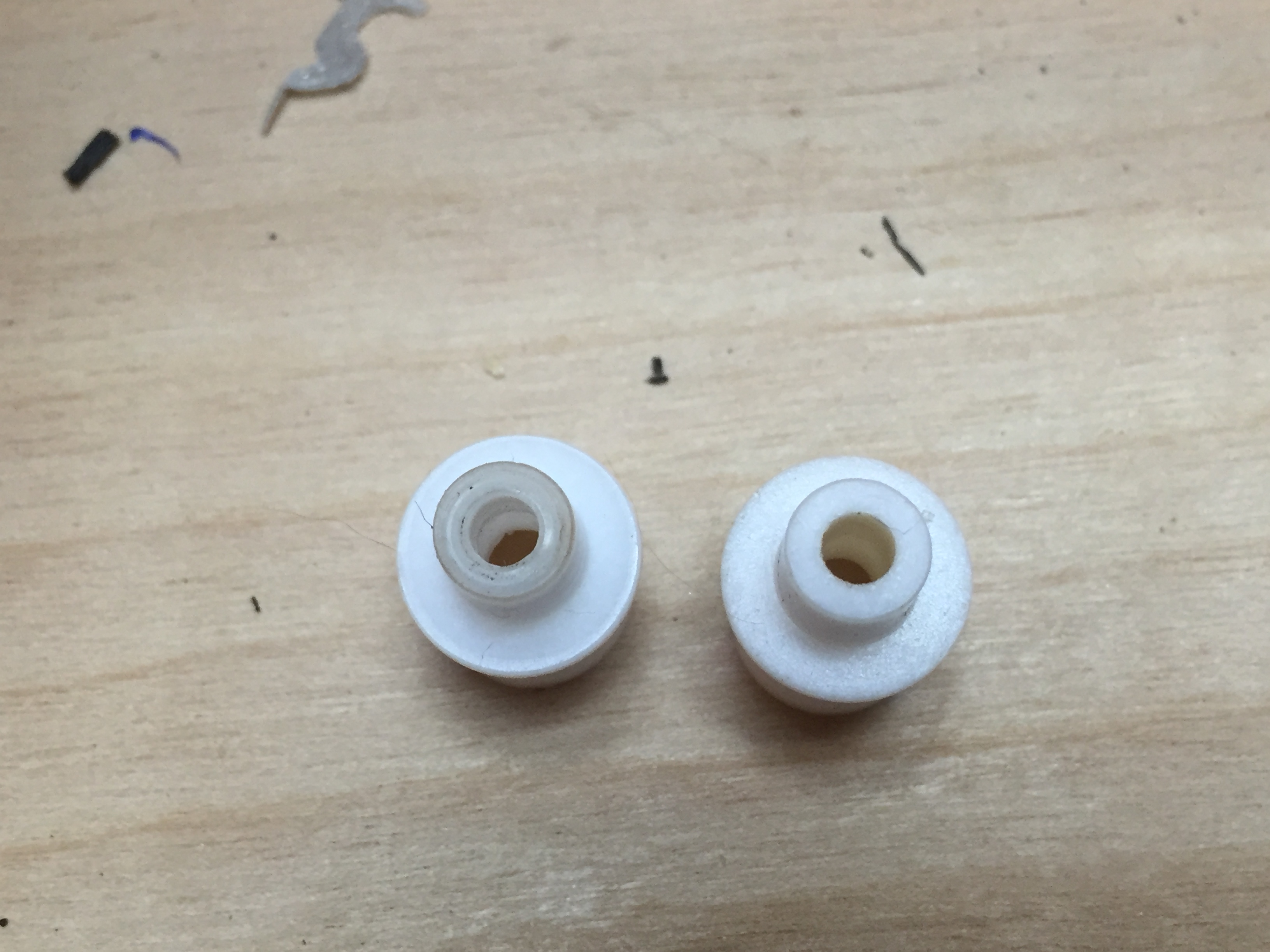

Re: My prints lean forward!
Post by Neotko » July 12th, 2016, 2:34 am
Ptfe coupler? Still the same?
Post by Amedee » July 12th, 2016, 6:43 am
Neotko wrote:Ptfe coupler? Still the same?
You beat me on this...
Phil.
Posts: 3237
Post by LePaul » July 12th, 2016, 9:01 am
Now wait...when I thought about replacing it, the opinion was to leave it alone? :)
And keep in mind this is nGen, not PLA, so my thought was bad settings for the filament

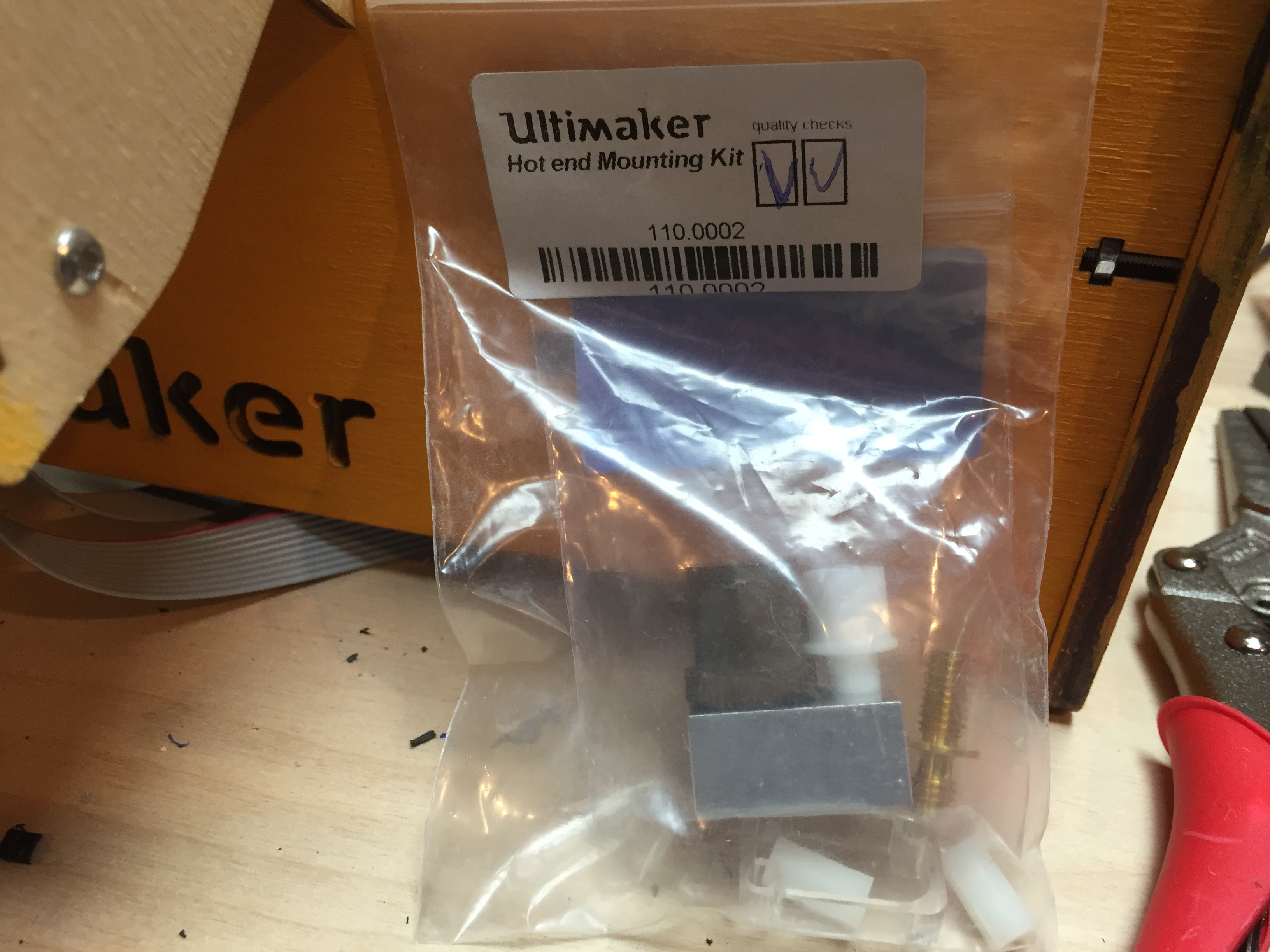

Now I still have a bag of print head parts from the dual extruder option. Or..should I be using a newer version to replace it?
Post by Neotko » July 12th, 2016, 9:32 am
Get the spare one, test all works. And if you ever install the dual, buy one.
Posts: 3237
Post by LePaul » July 12th, 2016, 9:42 am
Ok, I'll have to dig up the manual to properly dismantle and install it
