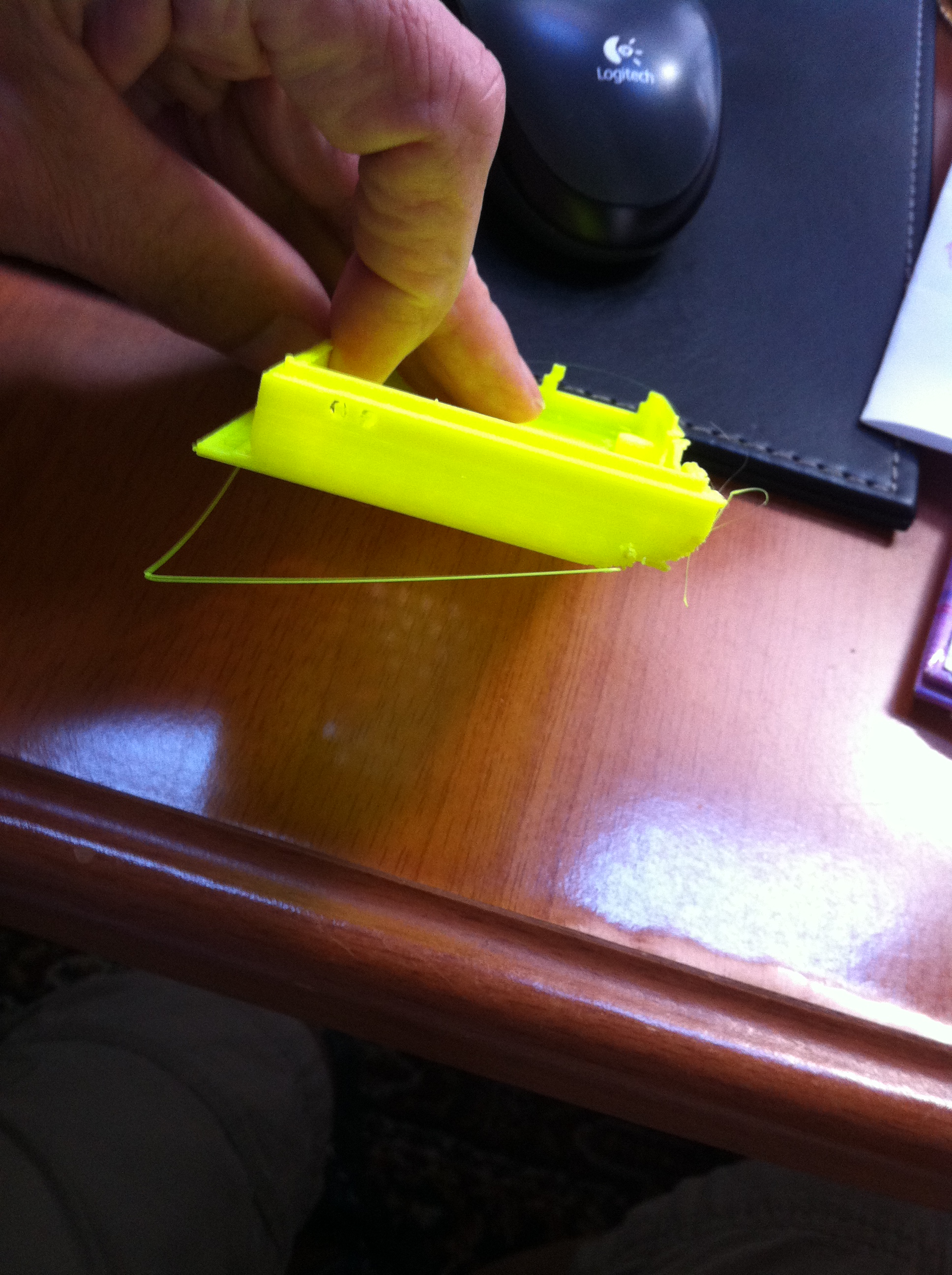

I can print a part that has a small footprint (X&Y) OK but when I do something bigger I get an offset in the x or y, or both.
I have attached a photo of the worst one.
I have checked the cable that go through the umbilical, or whatever it's called, that flexes along the x and y, it was a bit stiff.
This seemed to cure the worst of the problem.
I have checked the motors for overheating, they are cool.
I don't know where to look.
Can anyone help me please.
Thanks in advance.

@Samurai might have a good idea about this...but if you have an offset all the way thru the print, I would guess the belts first.
If it was doing this midway through the print, I would wonder if your extruder motor is skipping steps
That color filament makes it hard to see if there are artifacts of skipped steps (i keep zooming in)

I think I have solved the problem.
It was gradually improving the more I printed.
I tried various positions on the bed and found that if I printed close to "home" there was no problem.
This morning I checked everything mechanical. I added a link to the umbilical on the y axis, 1 more than in the instruction. and tightened all the screws. I made sure the x axis was square etc.
I oiled the rails and check everything ran smoothly.
It is now printing perfectly.
I am not sure what the problem was because the belts were OK, it most just have been something sticking.
Thanks

Post by Lez0 » February 9th, 2018, 8:44 am
Hi all
Found the solution to the slipping in the Y axis as above.
I tuned the motors, I increased the power by a quarter turn see:
It has been working for a few days now without any skipping. :-)
