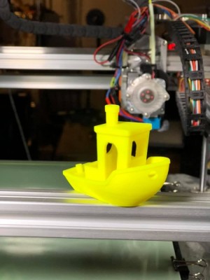

I also wanted to fine tune the Titan Aero, which is equipped with a pancake motor (lighter than a stepper). Calibrating esteps on a direct drive is always a challenge. The extruder moves way faster than it ever would be for a print, so slippage is going to happen. And that was the case. I could get about 90% through but never 100% due to slipping. I opted to do the math, provided by E3D and the degree/rotations the motor was rated for. I set to 418.5 and decided to do a series of extrusion multiplier test prints to see how close my settings would work. In short...quite close!
