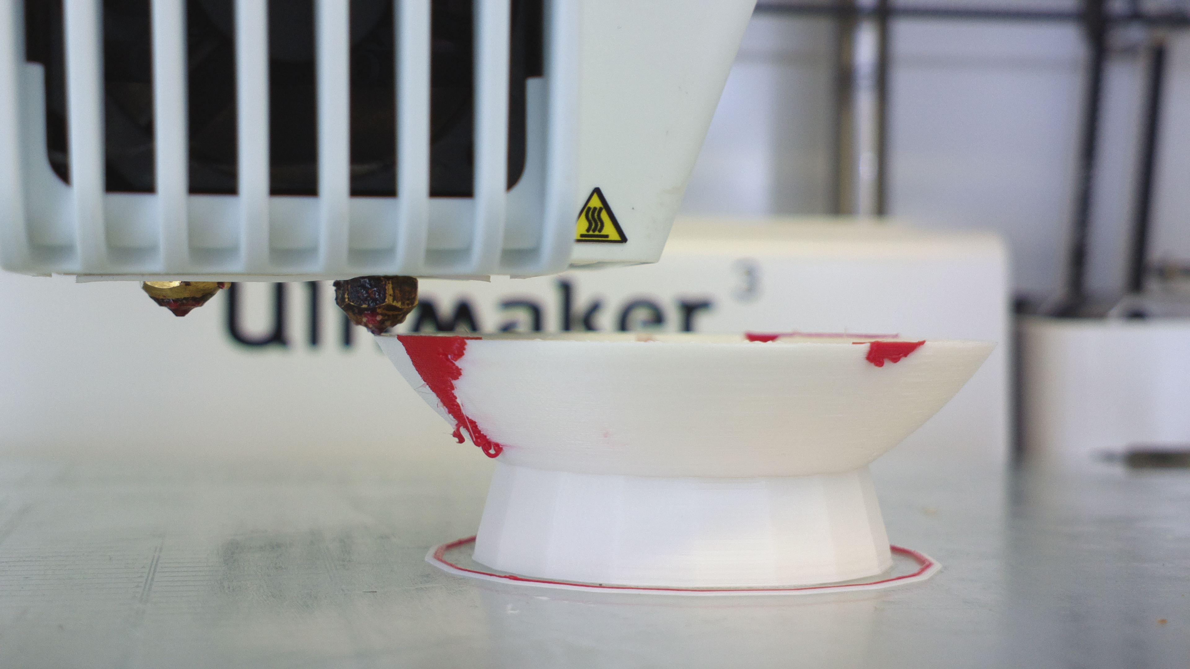

Printing with ABS with dual ruby nozzles, without priming tower:
(I forgot to tighten the right nozzle, so it is a bit dirty due to the plastic that leaked the first hours before I noticed it)
The ruby nozzles actually appeared to ooze slightly less that the UM3 nozzles in my initial tests.

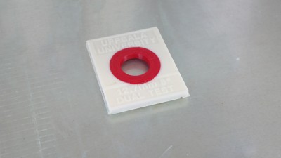

Here is another interesting one, the white is TPU95A and the red ABS, no priming tower here as well:
There were some strings on the upper right corner that I removed, but apart from that I was amazed how well the TPU95A prints on the UM3.
TPU and ABS does not bind together that well by the way, so one should either design interlocking structures (like I did) or possibly increase the overlap.
