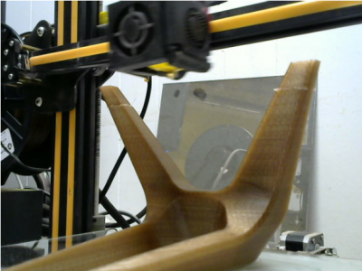

Mixed results. I just had Octoprint crash 40 minutes from finishing a 14 hour print (of course, using my most expensive coffee PLA). I think I recovered, mostly, but it was painful. The printer at least showed the XYZ coordinates where it stopped. Octoprint web interface was frozen since early this afternoon when I left to run errands and I didn't bother checking the web interface when I returned as it was still printing strong.
I mostly recovered, and this is a print just for me, so not like I am completely out $13 in material (this print normally would cost $3.85 in Hatchbox Black, but coffee PLA is $45/500g, 4x more expensive). You can see where it restarted in this photo. Edit: The reason I say 'mixed results' is that this is the only plugin I have installed in the last month, and I haven't printed very much since installing it. Not sure if it is directly related as there is nothing in the logs to indicate where the failure lies (actually, the logs also stopped about 5 hours before octoprint app crashed). Note that the RPI that is running Octoprint service is very much alive and well, and didn't require a reboot.
