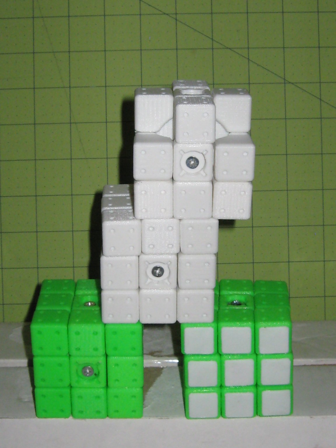

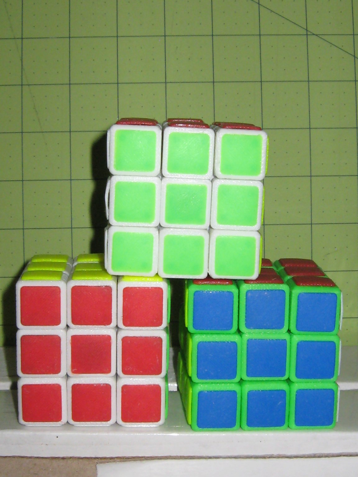

They actually work better that any cheap Clone Rubix but not a good as the real Rubix.
Only takes 12 hours to print all the pieces.(6 because I have two Printers)
