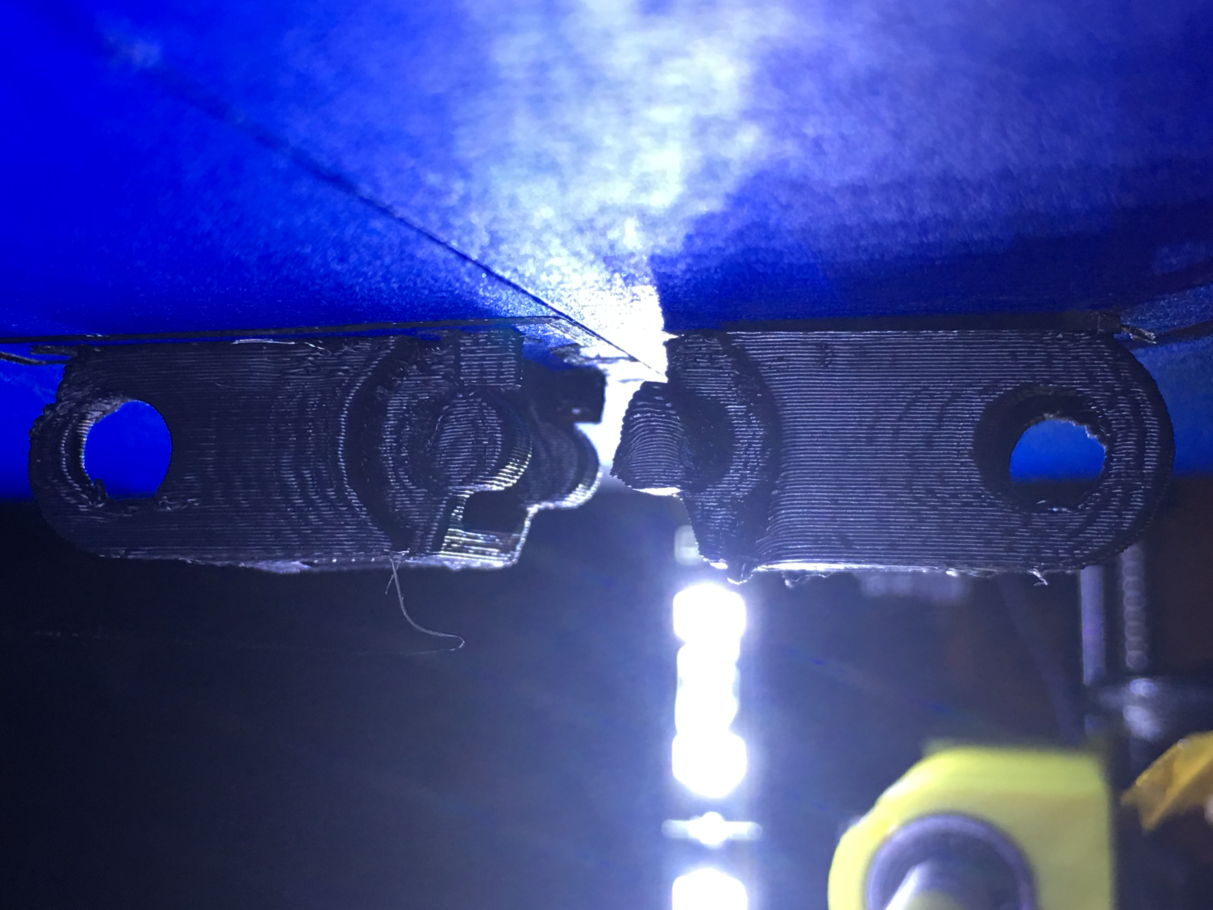

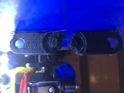

Help with print quality
Strange photos were posted right side up an it appears as though they flipped when I uploaded them.

It could be that the cooling fans are not effective directing the flow, you may also be printing slightly too hot.
Check the direction and coverage of your fan ducts too see if you are getting all round cooling of the part.

Re: Help with print quality
That is a strange one. Can you share or link your .stl file so someone might also try printing it?
