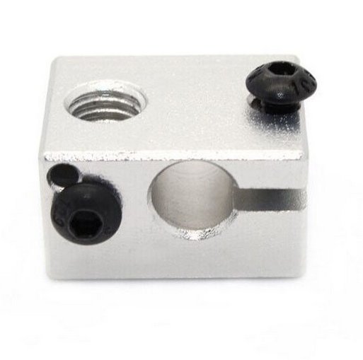

I have noticed that there are two styles of heat blocks.
horizontal
vertical
The first is the one I am currently using. It has a 10mm heat to throat.

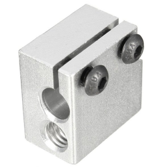

The second one has a 20mm heat to throat.
This give the filament twice the time to heat before leaving the nozzle.
Is there any information that could be used to determine is any advantage in speed by upgrading from a horizontal heat block to a vertical heat block.

First one is the typical E3D v6 heat block clone... the second one is the typical E3D Volcano heat block clone
Posts: 3393
Re: Hotend Heat Blocks
Post by LePaul » June 28th, 2018, 9:28 am
Yes, what @Chaco said. If you want to print a lot of volume (big nozzles...or as they say, print like toothpaste!)...those work well.
