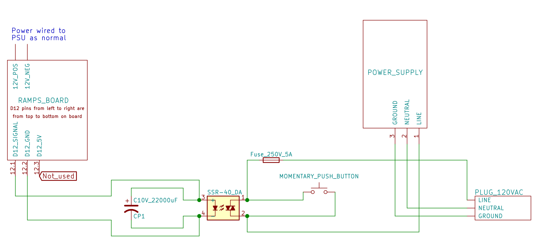

Wiring schematic
Assembly
I bought a new power cord as the one that came with the printer was flimsy and only had two leads. I got mine at Lowe's or Home Depot but it's similar to this one that has 16 AWG wire in it. I just cut the end off (the side without the metal prongs!).
Assembly is easy if you can follow a wiring schematic (linked above), so I won't type it all out step by step unless someone gets stuck -- then feel free to post and I'll do what I can to help 8-) You can skip the capacitor if you're not using OctoPrint.

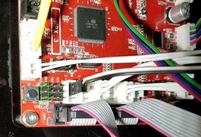

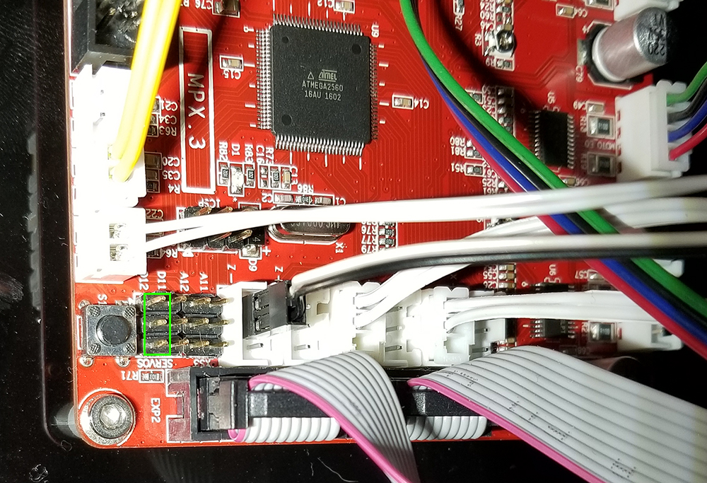

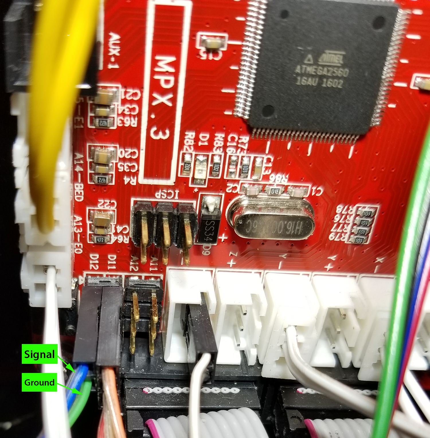

Here's a picture of my board with the wire that controls the relay connected to D12 and a BLTouch connected to D11

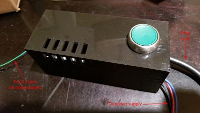

Everything wired up, before I screwed the enclosure shut. I put some hot glue around the top of the capacitor to make sure the leads are insulated.
All closed up and working

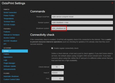

- In OctoPrint's settings, click the 'Server' section on the left and change the 'Shutdown system' command to 'octo_shutdown.sh' and then save your settings.
