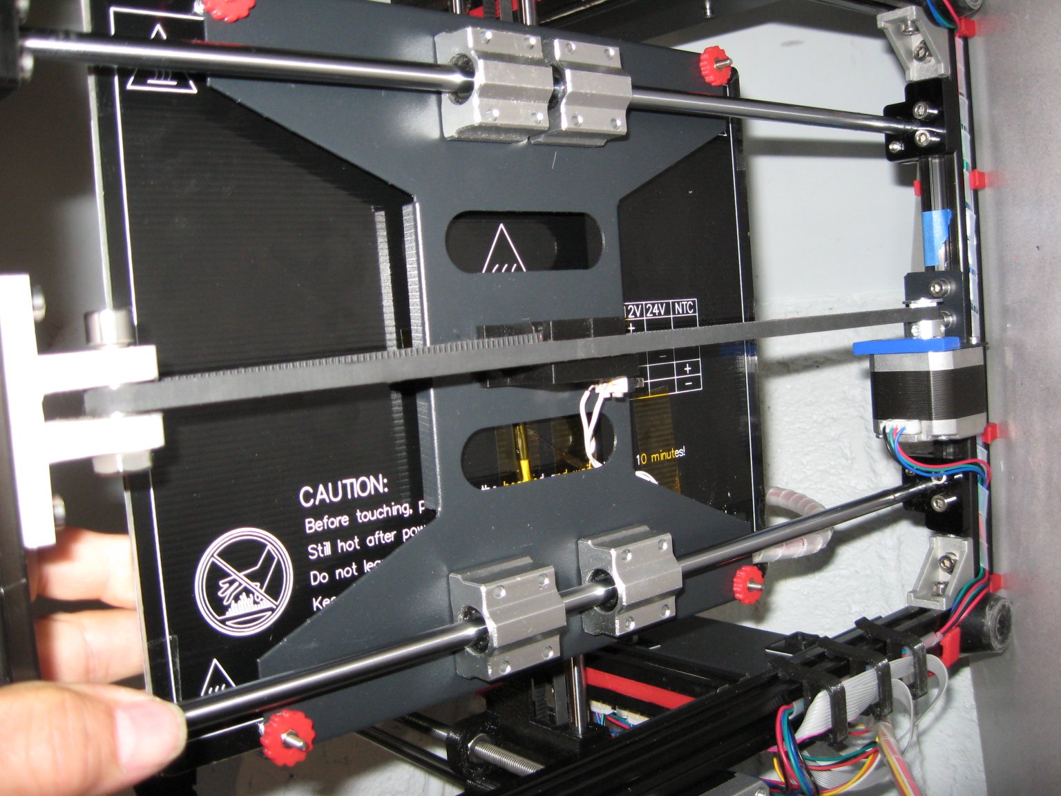

I have been using 4 bearing for about 8 months never had a problem.
Only problem ever had was when there were only 3 bearings as the carriage would move funny on the Right hand side causing uneven print lines.
Most likely because they were inferior bearings.
Was using four printed Bearings during this time. About a week ago they started causing problems and were replaced with Original style non inferior bearings, still using 4 bearings.
