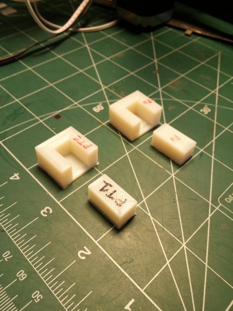

Perimeter Test Object,
Got done with Feed Rate and Nozzle Temp test and calibration (1). So, went back and re-printed the object mentioned here later in the message. Thought that the test object here would be better than factory defaults and post calibration, well... something is still not quite right.
First object : the inner would not fit into the bottom no matter orientation. Print looks good with solid infill and adhesion, perimeter shows Z-stepping or feed/temp issues.
Second object (post calibration (1)) : inner almost fits in, if you turn it on the side, it will side-fit with some friction = top-to-bottom dimension appears correct, infill and adhesion is poor, perimeters do look better however.
Will investigate further and tweak the setting as mentioned in the instructions, i.e. perimeter Width and Thickness setting in the slicer software.
