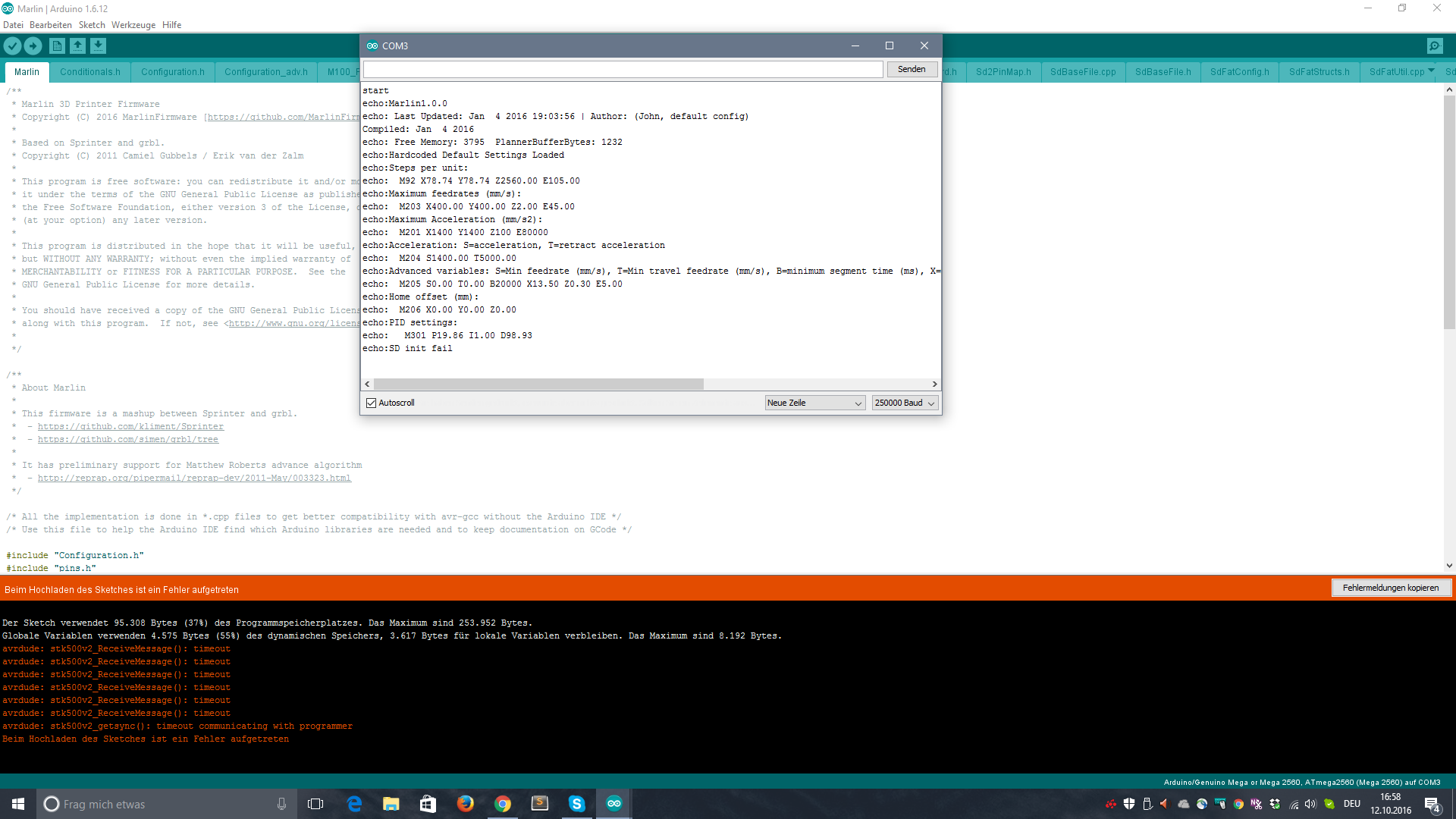

I'm having issues uploading the new firmware to my printer. As seen in attached I get a timeout. Image not sure why. I can control my printer in Repetier Host.

AndrewJLLeather wrote:I'm having issues uploading the new firmware to my printer. As seen in attached I get a timeout. not sure why. I can control my printer in Repetier Host.
Looks like your USB driver for the port or configuration is incorrect(?), cannot tell from that screen shot. Also, you should have Repetier host shut down or DISCONNECTED prior to running the IDE and it's connection. What OS are you using?

hah. I was dumb. I did have Repetier Host running, and now this time I didn't, so I finally got around to successfully uploading new firmware. All is good. Running my first print since new firmware. Thank You Chip for all you've done for the community!

I've got an issue uploading the firmware.
avrdude gets timeouts:
USB-Driver:
CDM v2.12.24 WHQL Certified from here
I've already googled and it seems this issue appears pretty often on Mega2560.
Things I already tried:
- shorter usb cable
- replaced the avrdude in the current version of arduino with an older version (0022)
- tried to recompile avrdude on windows with higher timeout rates, but failed since i am missing corresponding librarys
Do you have any suggestions?
