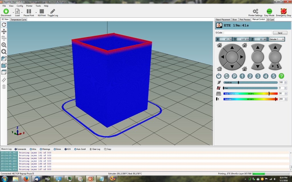

Watching the printer print using nothing but the gcode from my last print/output when I used Slic3r for printing, now is currently running on the Repetier software only. Sure is nice to see actual real-time status on the print and other variables visible along with an GUI E-Stop switch.
Will be interesting to see how this test cube compares to standard SD card only prints.
HICTOP re-printing test cube over USB for the first time

Chip Luck wrote: Watching the printer print using nothing but the gcode from my last print/output when I used Slic3r for printing, now is currently running on the Repetier software only. Sure is nice to see actual real-time status on the print and other variables visible along with an GUI E-Stop switch.
Well, it should not be different IF you use the same gcode - file. If you slice it differently, that's another story. But in general, if you load a gcode file that was sliced before (let's say in cura) and you just use repetier to "stream" the file, it should actually not be different at all.
The advantage of using the sd-card is that you can shutdown, disconnect your printer => especially for really long prints i would recommend that. As with pc's we never know. When they hibernate, stand-by they tend to shutdown USB / serial => stops printing!
