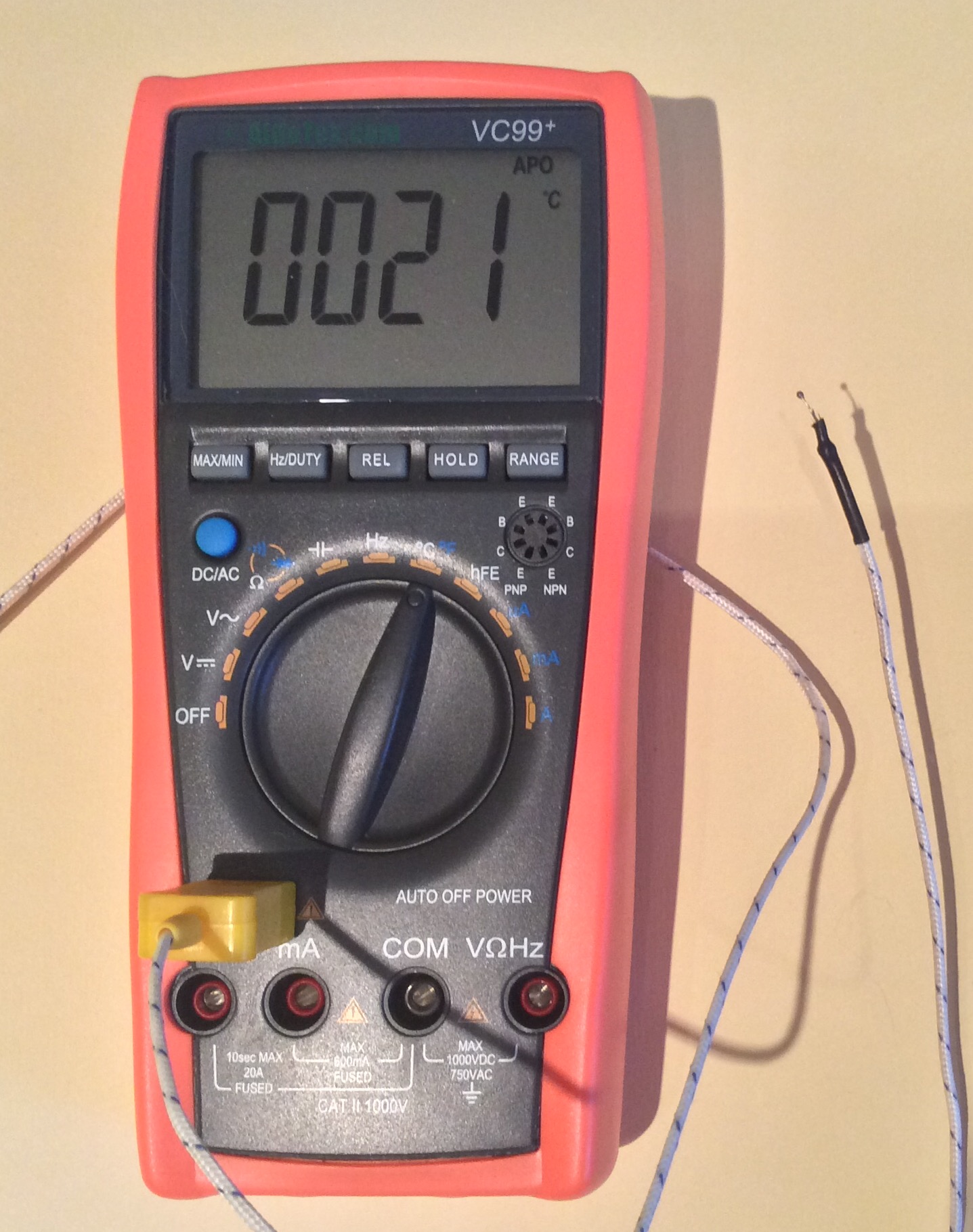

Ok so here is a photo of my multimeter with the temperature sensor.
As you can see it has a small round tip, each temperature measurement was taken a least 3 times to average the reading and the sensor was held in place for 15 seconds for the reading to stabilise. The very tip was used to take the readings and was applied to the surface which was free of any plastic. As well as the 200 and 230 I also took a set of readings at 150 which fell within the same pattern.
It's the best I could do with the equipment I had, I hope, :-)
Izzy.

You equipments seem to be ok but as Anders pointed out a bit, there are a lot of effects to be considered and whenever possible to be excluded.
On the long-term equilibrium state heat conductance through the sensor certainly plays a role. However, the biggest influence I see with measuring at different spots is the ambient temperature. I fear the thermal contact between sensor and measurement spot might be insufficient. I would recommend to repeat the measurements with some copper grease or heat conducting paste on the temp sensor in order to ensure proper thermal contact. If the contact is insufficient, ambient temperature has a large influence and reduces the reading.
