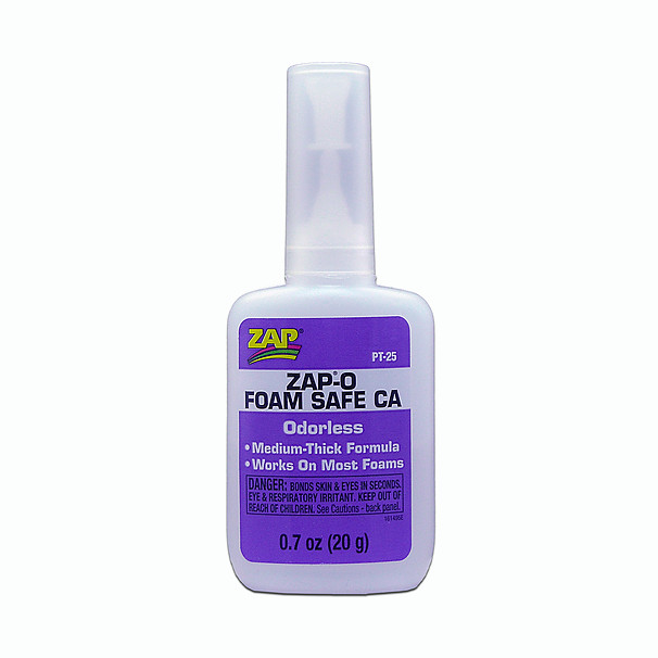

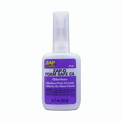

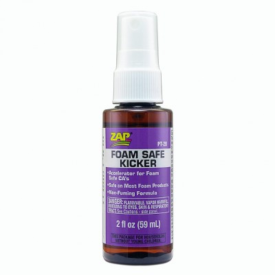

We always glue PLA, PLA/PHA, nGEN with CA glue. It still works when you mix these types.
I like the 'Purple' one from Zap (Both CA glue and accelerator) because these are less 'aggressive' (foam-safe) and are odorless.
All our gasometer was glued with it.
Purple CA
Purple Accelerator

Amedee wrote:I like the 'Purple' one from Zap (Both CA glue and accelerator) because these are less 'aggressive' (foam-safe) and are odorless.
Great, and I can buy it in Sweden. I will put this on my list to try asap :)
(I found some hints to other types of glue but those were banned in Sweden.)

The CA glue and Kickstarter is good stuff....used it to put together my (ABS) Stormtrooper armor :) (Have to glue trim pieces and snap plates)
