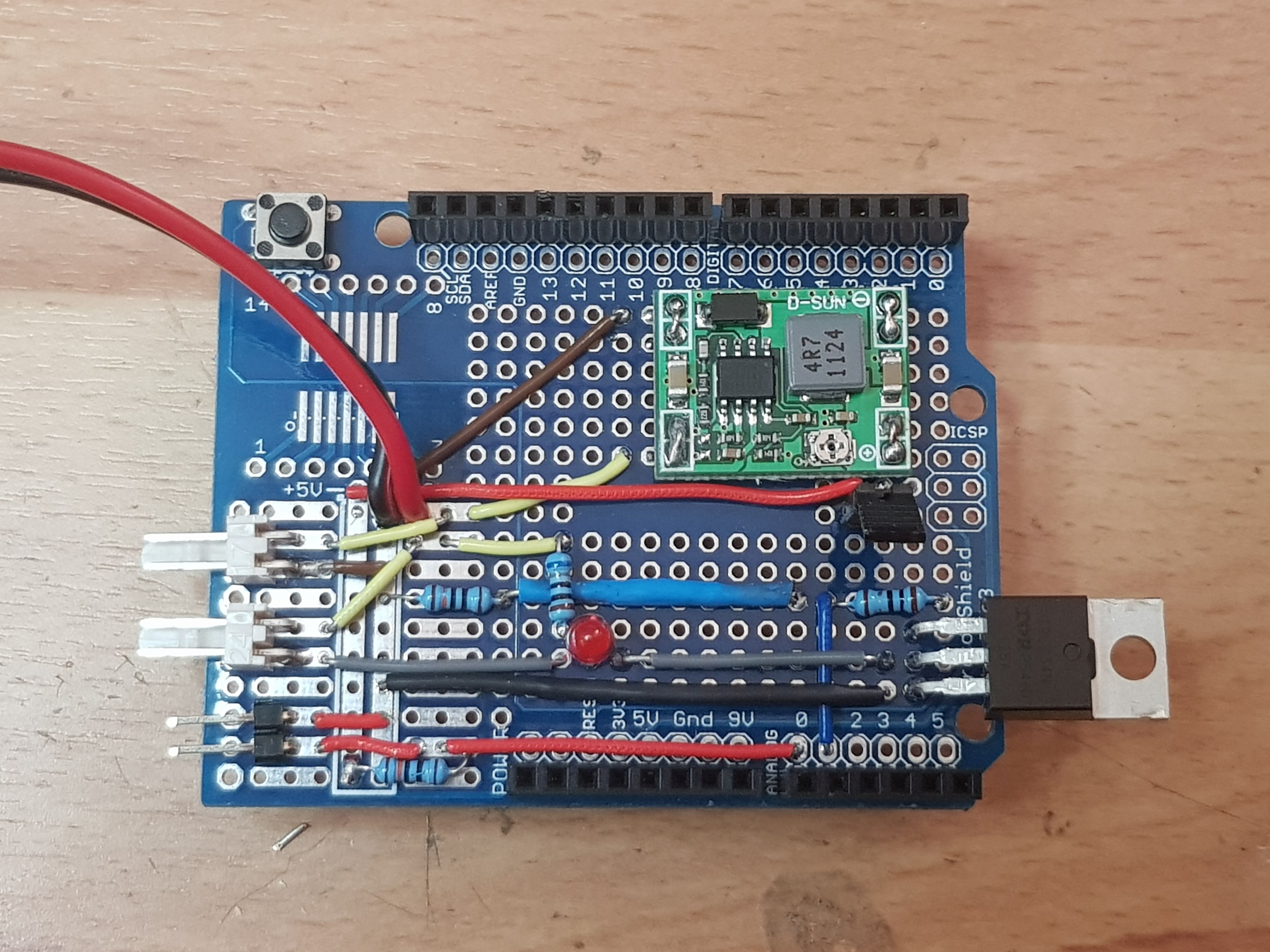

I finally managed to convert the ideas that I had collected over (too many) months into an Arduino shield to drive the filament fuser!
The shield has a 12V input, an optional 12V to 5V step-down converter to drive the 5V part without the need of an USB connection and the necessary parts to drive the fan, the heater and measure the temperature of the hotend with the 100K PTC.
Now I need to work on the software. I have a LCD shield with buttons that I want to use as "user interface". Currently the code can already measure and display the temperature. Next step is to develop the PID code that will control the heater based on the temp sensor readings. Once that is done, I need to code a menu to select and maybe store the target temperature(s).
Reiner.

It is surprising how little modification is needed to convert the Adafruit Sous Vide cooker code example to a working filament fuser code :lol:
I used the Sous_Viduino code from Adafruit as a starting as it has a menu, PID and storage for set values and uses the RGB backlight version of the monochrome backlight LCD display and button shield that I have. So I only had to remove the backlight related color changing code and replace the OneWire/DS18B20 based temperature measuring code with my existing code for the 100k PTC. Some more smaller changes to use only one digit precision and here it is: Version 1.0 of the filament fuser and the details on how to build the shield! :-)
It heats up fine and seems to keep the temperature fairly okay after reaching the set temperature. Now I can start with some fusing tests...
