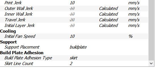

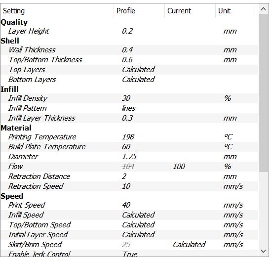

When this issue started, i printed two 5 hour prints and they printed beautifully. The next day i started a print and the first layer infill is way over extruding. i am using the same cura settings i have been using successfully.
things i tried:
  • bed level (tried near and fare from nozzle) i have been using a business card successfully.
  • lowered flow rate to %90, made no difference. (i have been using %104 successfully)
  • reloaded the skynet 1.1 firmware
  • tried multiple models i printed successfully before

Infill should not be .3 with a layer height of .2. If I am not mistaken your Infill Layer Thickness should be the Same as or a multiple of the Layer Height, with a .4 nozzle.
Example with a Layer height of .2 Infill Layer Thickness could be .2 (any more is beyond nozzle capacity)
Example with a Layer height of .1 Infill Layer Thickness could be .1, .2, .3 (any more is beyond nozzle capacity)
Example with a Layer height of .05 Infill Layer Thickness could be .05, .1, .15 ..2, .25, .3 (any more is beyond nozzle capacity)
As you are allowed to print the Infill at a different height than Layer Height. Print two layer height of .1 then print one Infill at .2

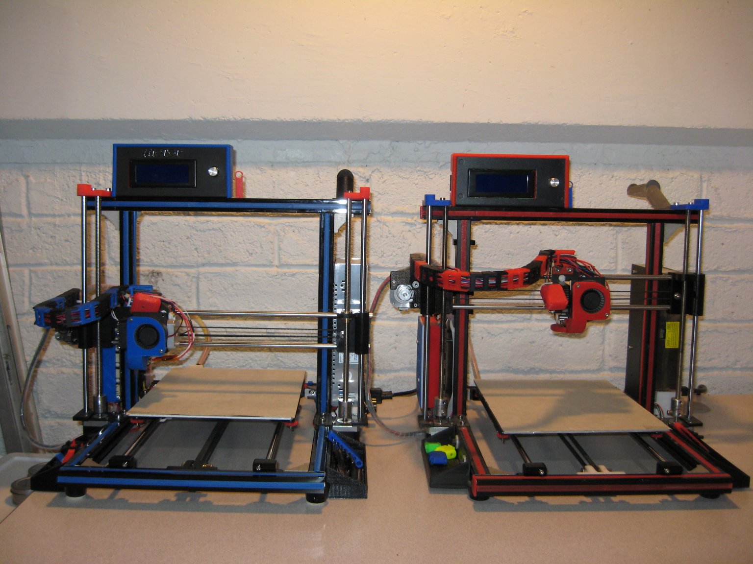

My printers temps for PLA vary from printer to printer. Red prints the PLA at 192C while Blu Prints between the same PLA at 198-202C.
I have never been able to determine exactly why one Printer with the same firmware and mostly same specs print so differently at the same temps.
Just so you understand red is my first 3DP11, an Blu is my second 3DP12 3D Printer (This is not the color of the filament) only the color of the Printers.
Attach a photo of one of your 3D Printed Models, and again show your print parameters.

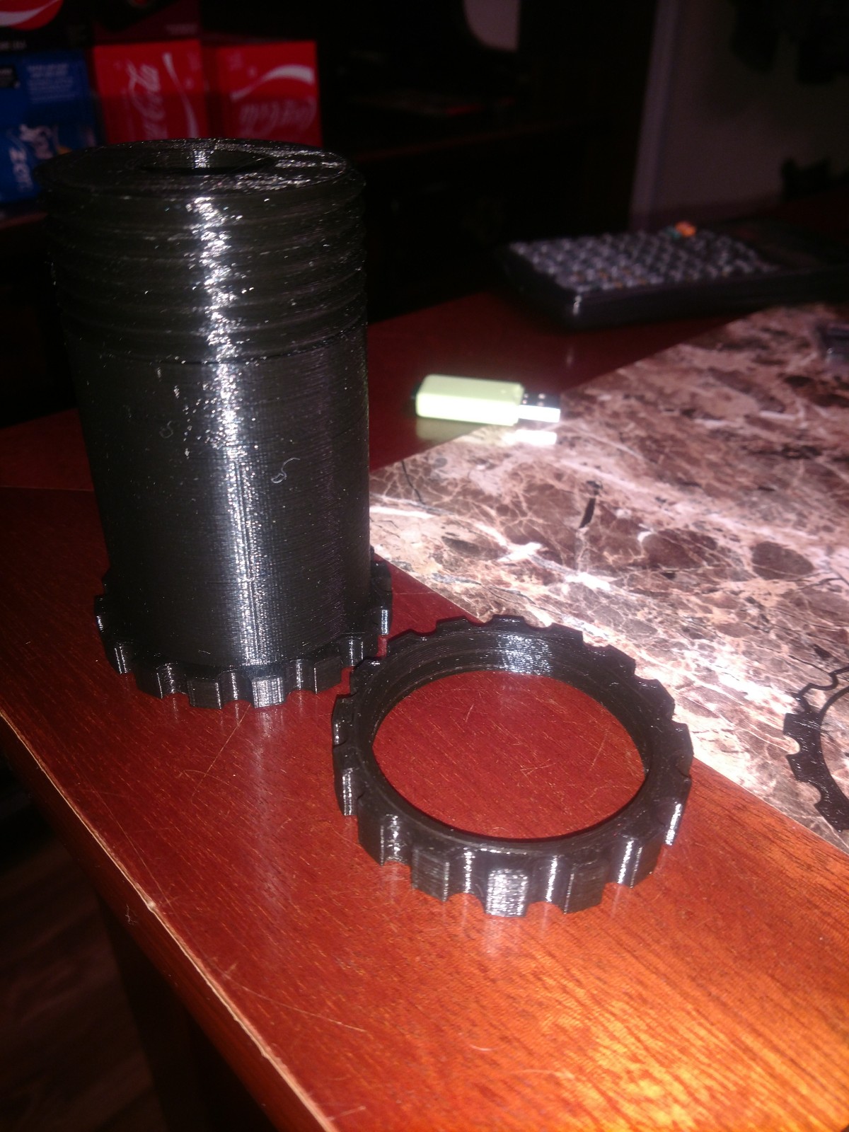

updating with pictures
good print i did the day before.

What he is telling you is that he has two virtually identical printers that he has code named Red and Blue that print very differently. AFAIK, based on the specs of these two printers, other than one shipping with an autolevel sensor, they are the same. I do know they use the same extruder and print head. The fact is, they print with very different settings.
And I have the same printers as a lot of people here (Hictop 3DP-17 - same as the 3DP-12 with an out of filament sensor, and the Hictop CR-10S). Both of mine have very different settings for PLA and extruding, even though they use the same filament and have the same print head (one is just a lot bigger).
So essentially, the best you can do is follow the online guides and tutorials for how best to tune your printer. If you want a printer that you can copy exact with settings online, go buy a really expensive printer that has it's own enclosure (like the Ultimakers - nice printers btw, just way out of my range).

BTW, I see some cross-pollination going on there. Red has Blu's Z brackets, and Blu has Red's.
That's almost as bad as swapping underwear with your missus. :-P
