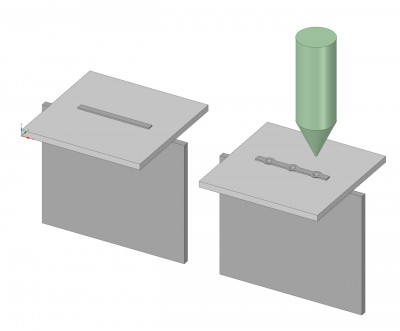

My upcoming printer build will have a steel frame as well, but a bit different. It'll be lasered stainless steel sheets (2.5mm probably) which mount together just like the UMO. But I want to get rid of the screws and mount the sheets together in another way. I was thinking of having them TIG welded at the anchors by a professional shop. Or maybe I try this:
Left side shows the joint parts before fixing them, and on the right they are fixed using a chisel to deform the anchors and lock them in place.

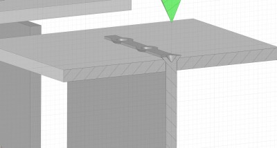

Section view shows how the deformed anchor is held in place.
All you need is a hammer and a chisel - both cheap tools.

I know the chisel's angle doesn't match, and there are other mistakes in the pictures. But these are just very quickly made mockups to show you guys the idea. With some refinement, this could actually work.
What do you think?
