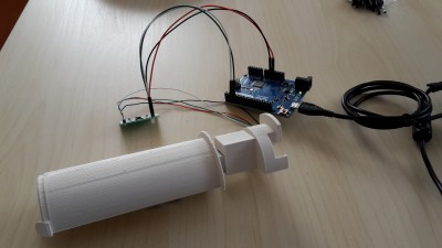

Post by reibuehl » January 7th, 2017, 6:33 am
I finally got all the printed and sourced parts together to setup a test. Here is the first prototype:
I calibrated it and now need to refine the code and add a small display :-)
I am a little unsure on what features are really needed - maybe a selectable "empty spool value" that gets automatically deducted from the measured weight...
Reiner.
