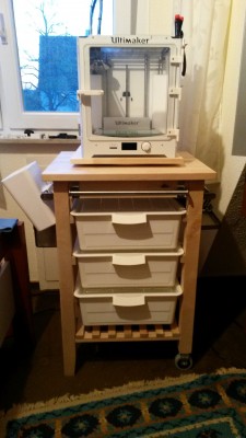

I used that inspiration to create my own portable 3D printer workbench:
The base is the IKEA BEKVÄM serving cart nearly unmodified. I just did not install the middle wooden grate. Instead I took it apart and used the wood peaces to create the slides for the plastic trays. The plastic trays are IKEA ANTONIUS 25l trays with lids, but I think they are not available anymore.

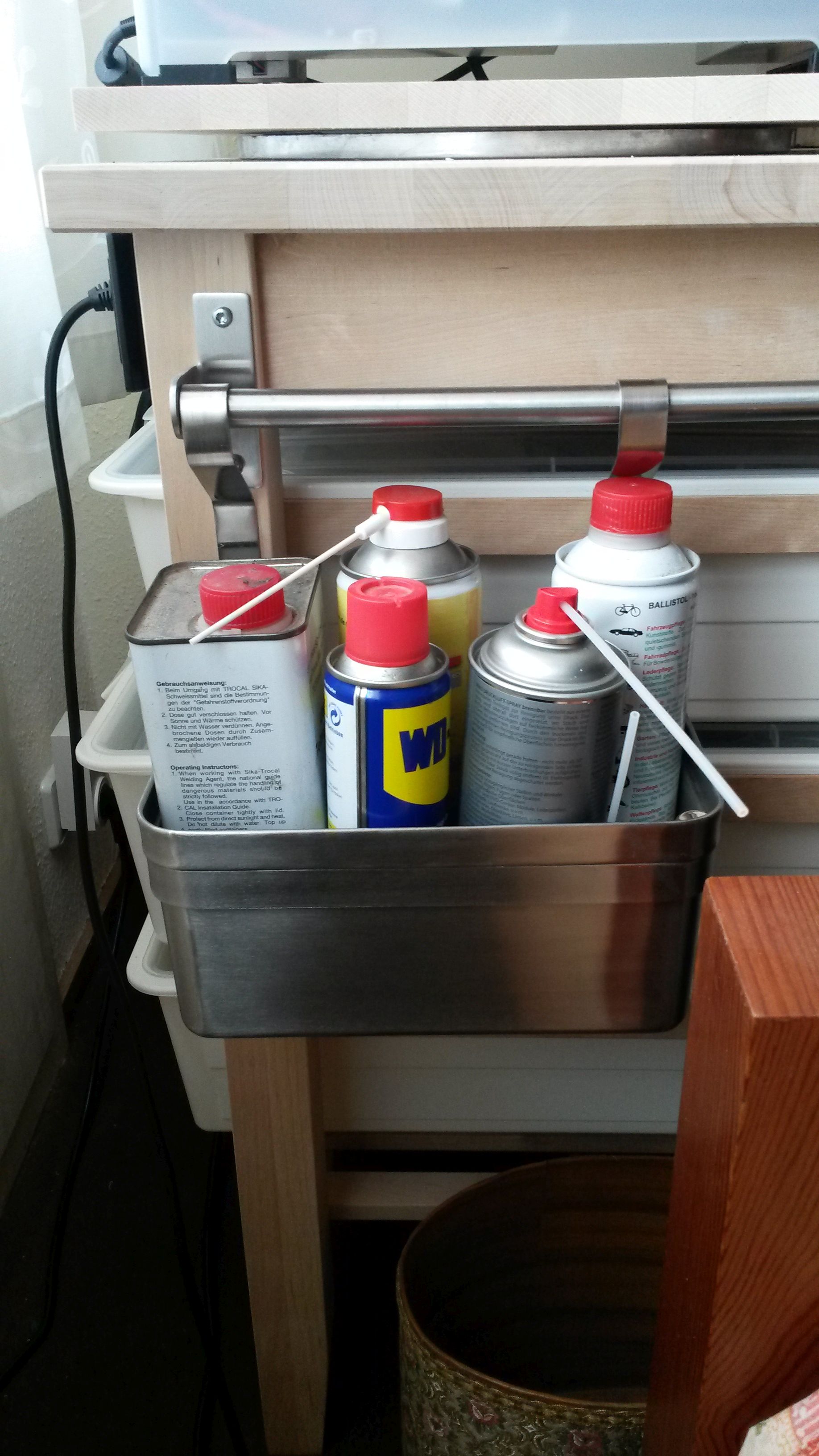

On the front and the two sides, I fixed 40 cm long IKEA GRUNDTAL rails. One is used as a handle when moving the cart and they can all be used for hanging all kinds of stuff. I have a variety of accessories - also mainly from the GRUNDTAL series in use.

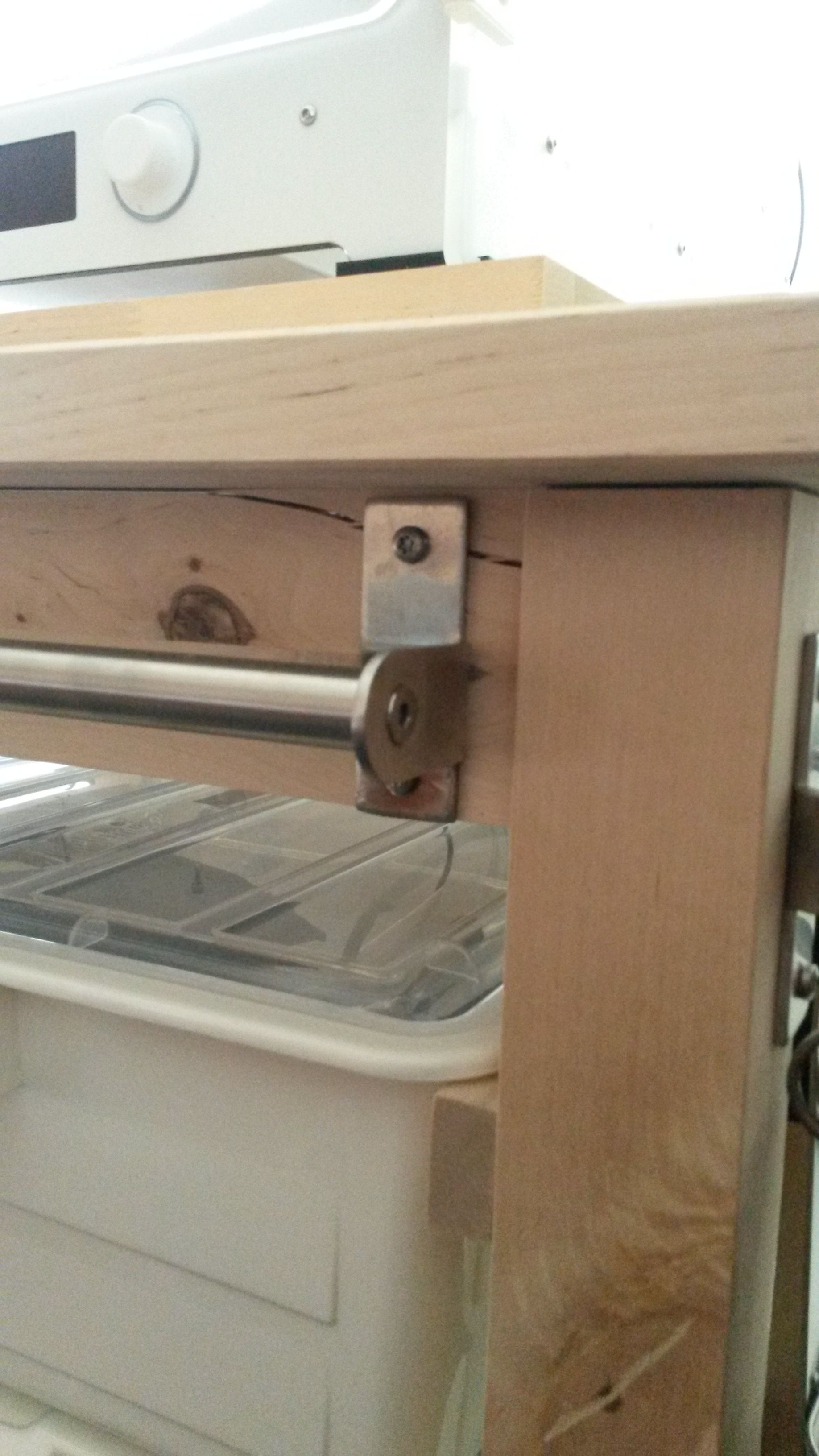

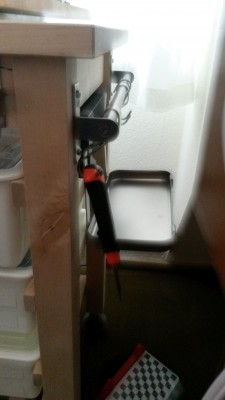

The mounts for the rail in the front had to be shortened a bit and a new hole drilled to keep them out of the way of the trays.

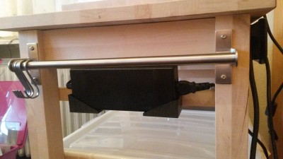

On the backside, I mounted a power extension lead with six sockets. On the left side, I fixed the power supply of my UM2 with the power supply holder created by Labern.

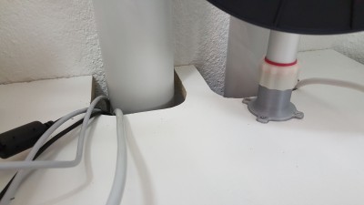

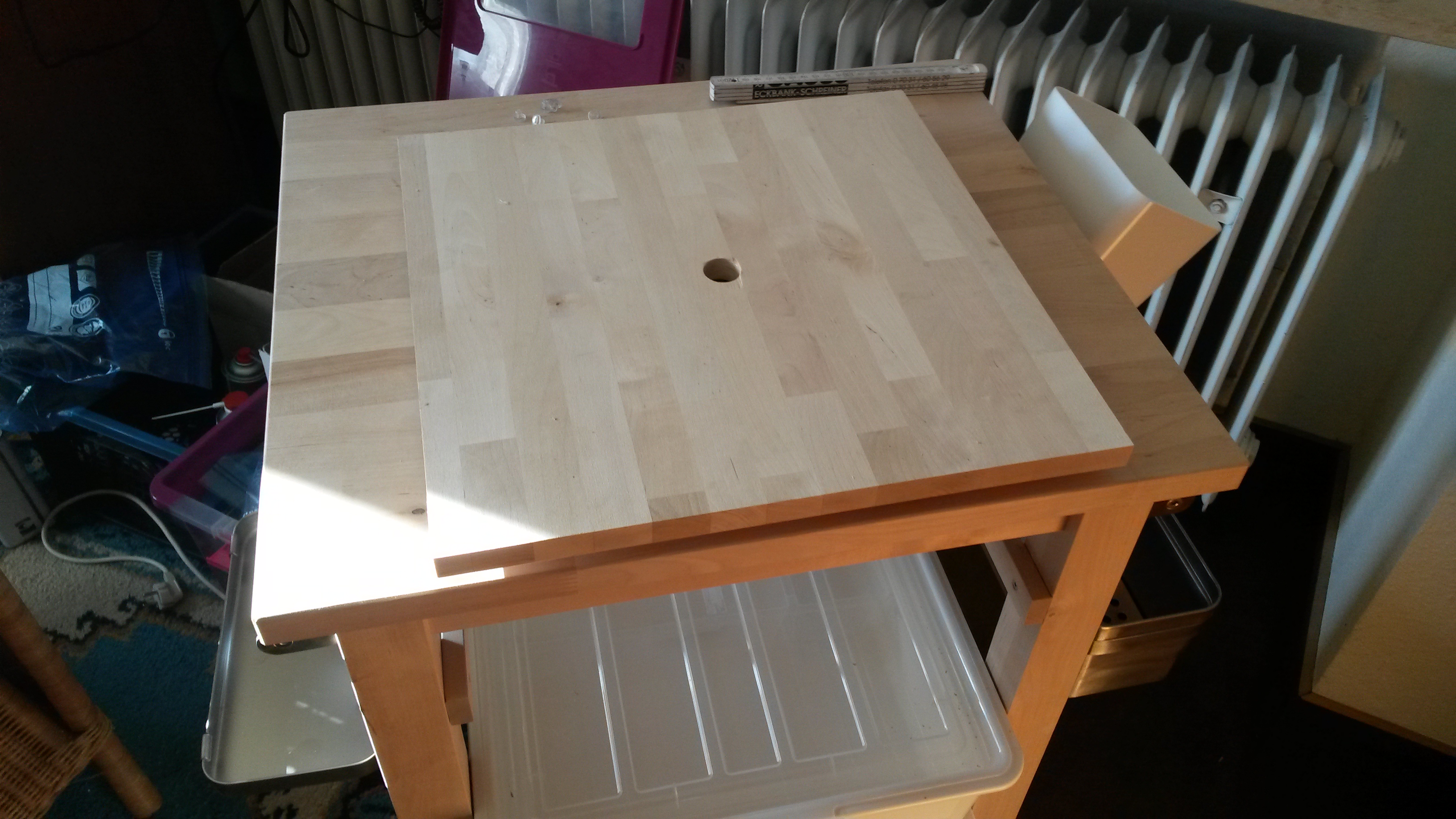

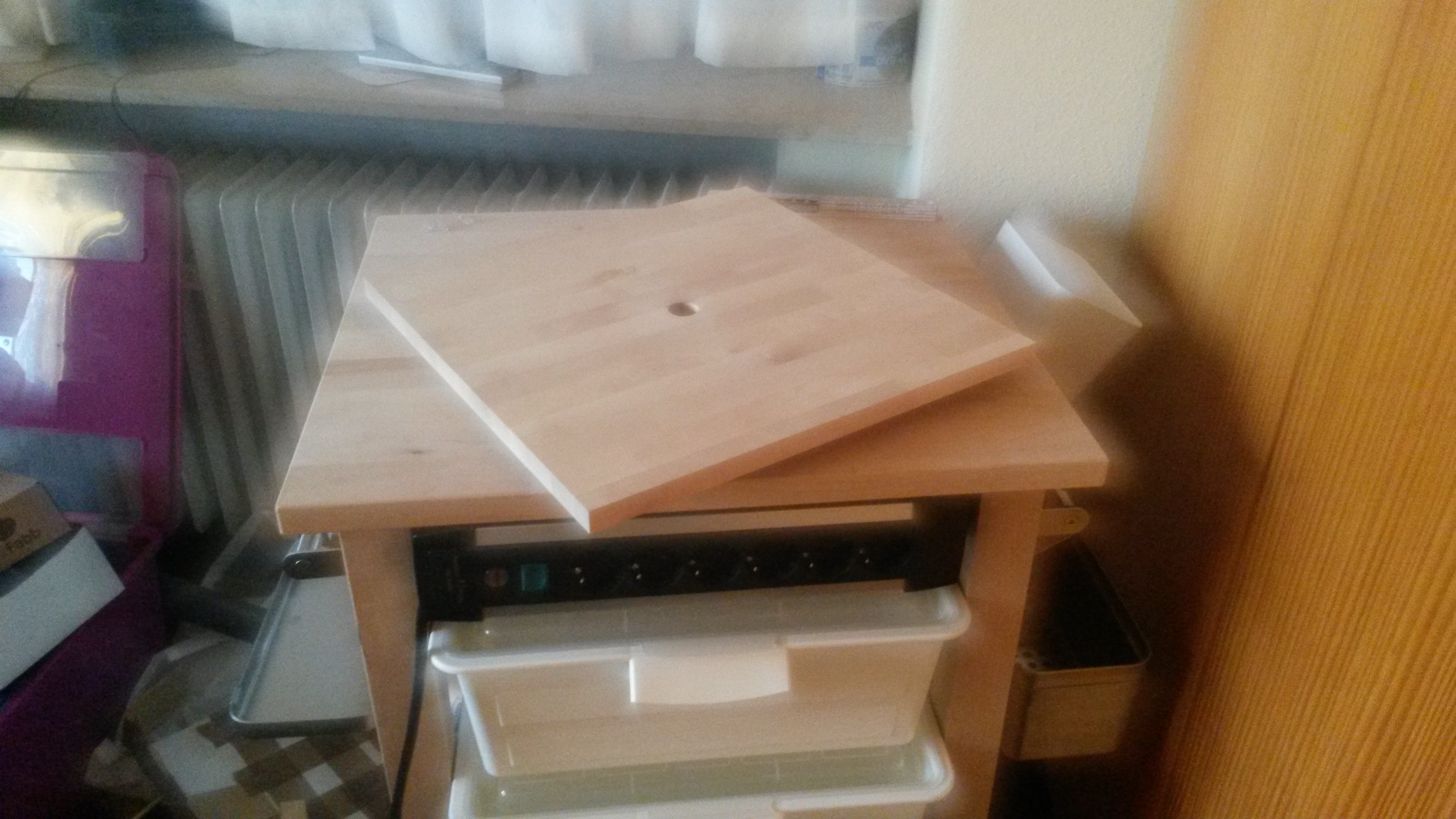

I then drilled a hole trough the top and mounted a lazy susan ball bearing on top with a square piece of wood as turntable. The turntable has the same hole in the middle. This allows me to feed the cable from the power supply to the printer through the middle of the desktop and under the printer to the power socket on the back of the printer. This way the printer can rotate >360° without any issues.

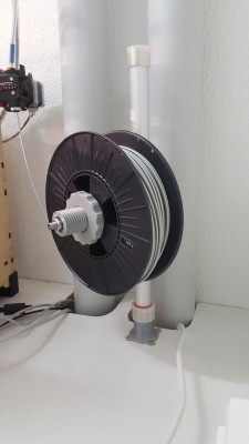

My version of the spool holder from IRobertI, re-designed completly in F360 to also fit DiamondAge Spools :). Mounted on a 25mm aluminium pipe cut to lenght (the height of the spool can be adjusted of course):
Some more detail of my mechanism to mount the pipe (the red piece is ninjaflex, the thread clamps the pipe with the ninjaflex piece) here you can also see the cutout for the piping:

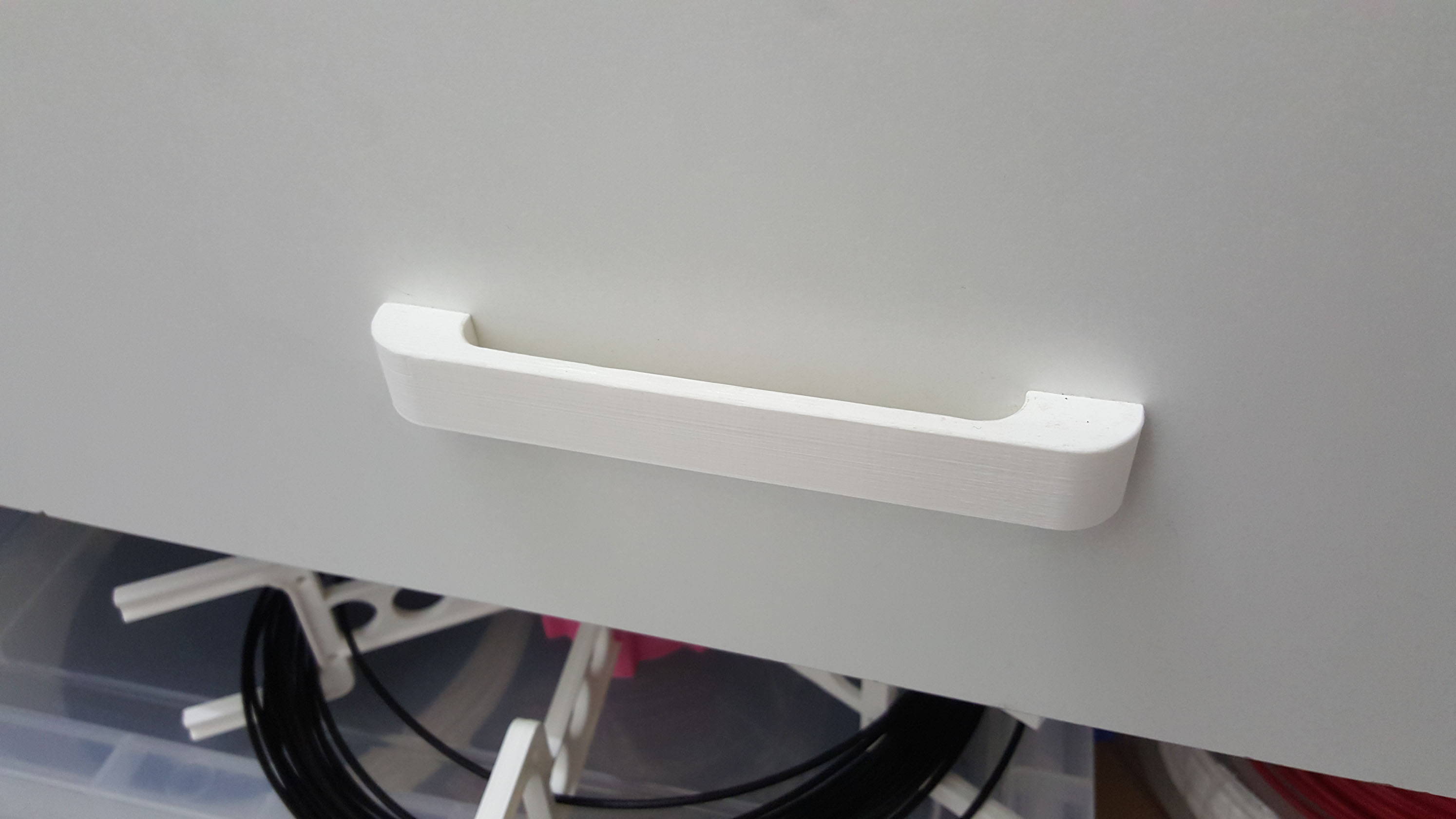

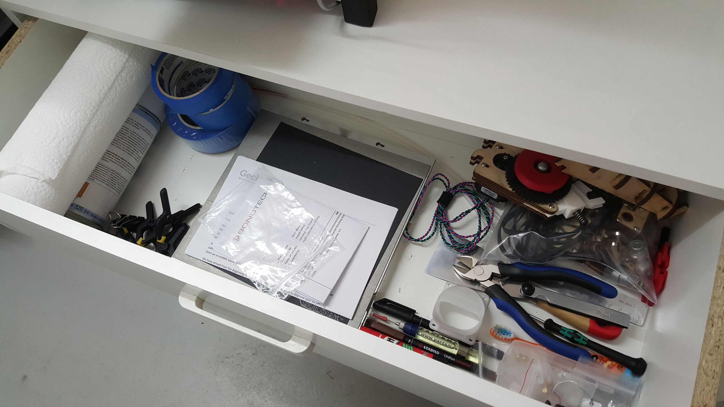

The drawer in detail, the handle is of course 3d printed, designed in F360:

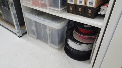

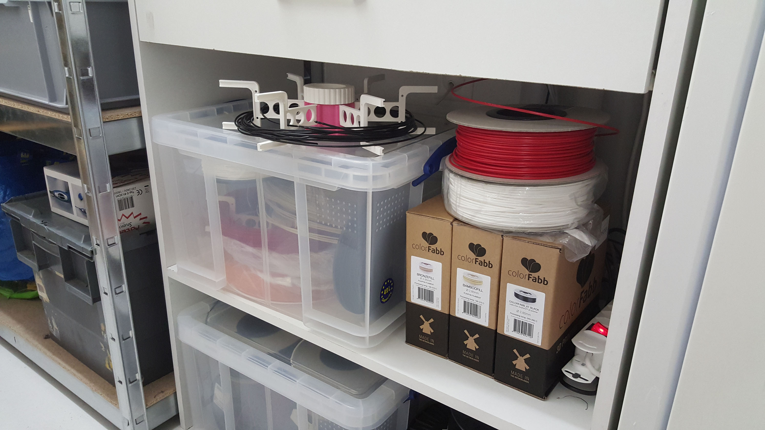

And then some storage of course:

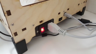

The printers feet (https://www.youmagine.com/designs/ulti-foot + Longer Version (Heated Bed Power Supply) + instead of rubber bands, ninjaflex inserts). You can here also see how I connect my HBK PSU (had to cut my UMO, that really did hurt!) inserted proper connector with light and fuse, so I can shut down the heated bed seperatly from the UM itself:

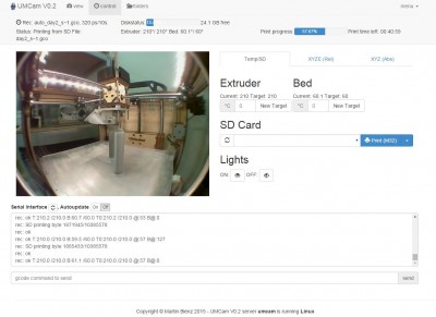

The printer itself, with my custom ulticontroller case, um-handle, twisterblocks (chopmeister), spacer and endcaps (dim3nsioneer), HBK (custom), gt2 belts and pulleys, bondtech qr3.0, my colorfab XT - fan (does NOT bend, wink LePaul), ikea dioder mounted, and my Raspi-Case with 2.8 inch TFT (PiTFT) with resistive touch to control my TL's, Light, monitor the printer etc. (written in python, pygame, tornado), also added a print screen of the current web view (tornado => bootstrap, fontawesome):
