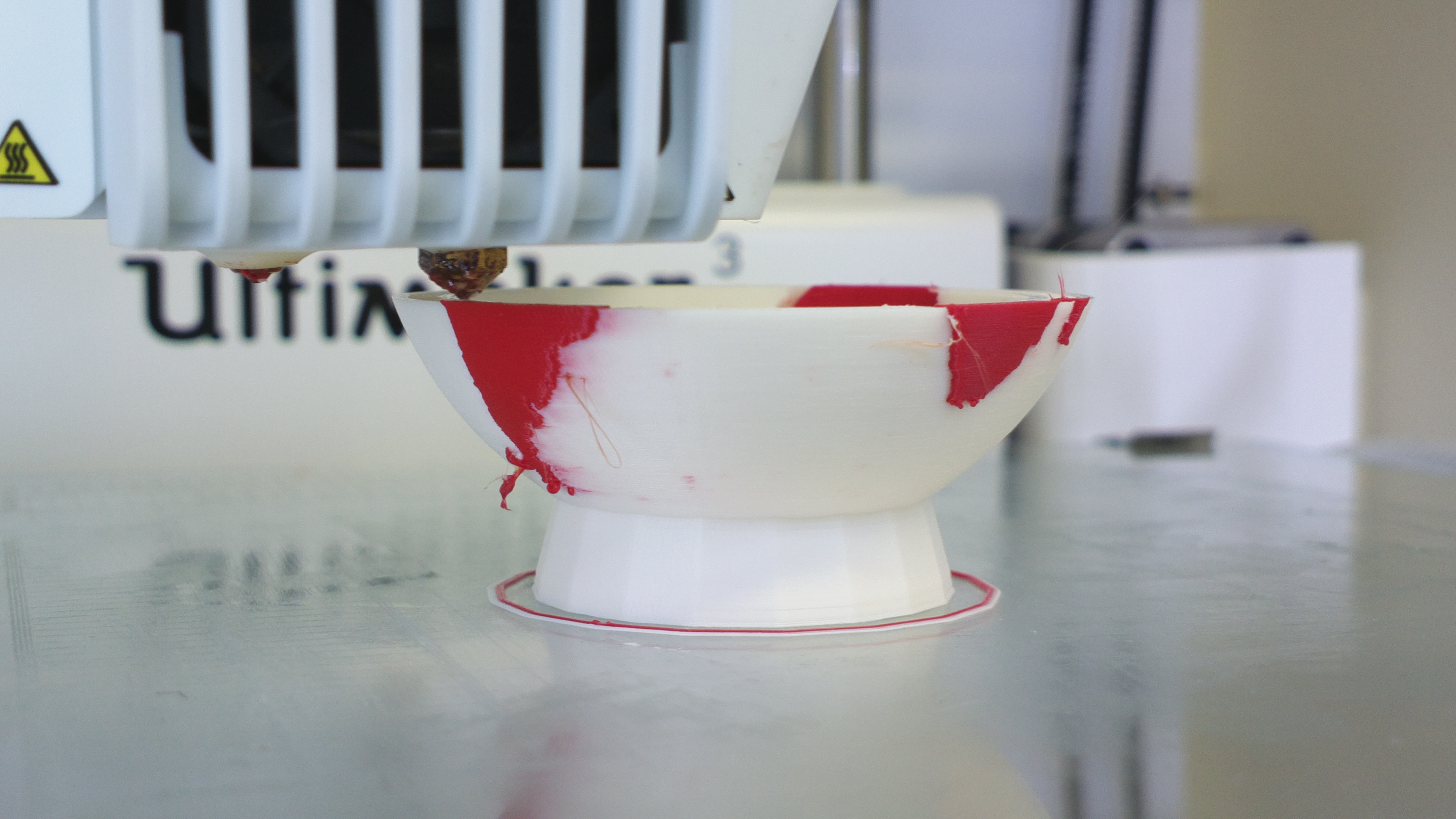

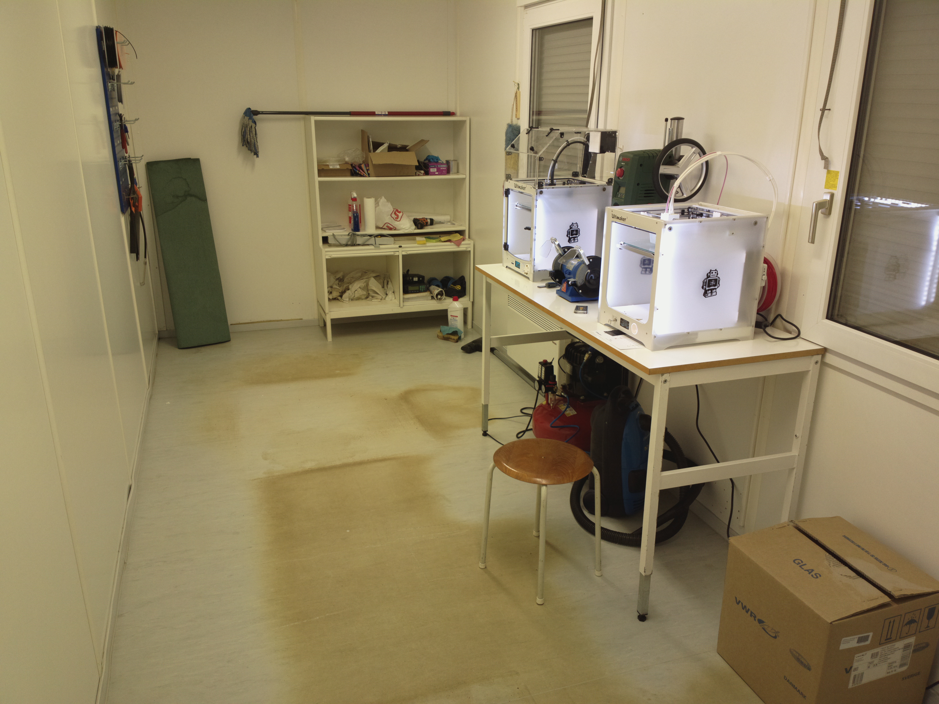

Been moving things to my new lab past days (my colleagues call it a Man cave ) Just started printing with dual ruby nozzles on the UM3 too, with my prototype UM3 Olsson block, seems to work fine so far: More about that later..
Hahah! I gonna try something like that tooAnders Olsson wrote:I have been incredibly busy past weeks, will try to catch up here.
You know who made it (but let's keep it here for the moment)

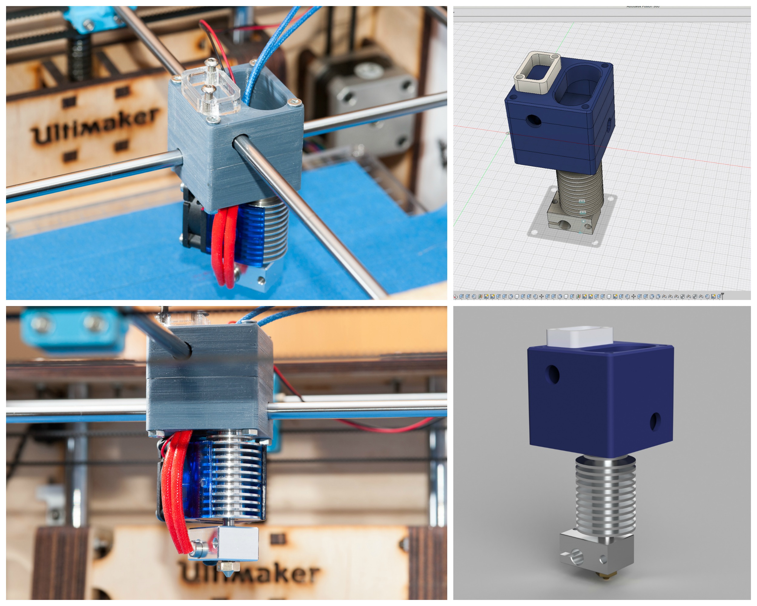

So I eventually decided to do something with the E3d hot end I bought years ago. I already started some design a couple of weeks ago, but then I was inspired with what they did for the UM2, so I made a similar version for the UMO.
The challenge for the UMO is to make it as small as possible because each millimeter beyond the 36x36 square (from the linear bearings) is a millimeter you loose on the build plate as the x/y blocks are taking much more space than the UM2 ones...
Still work to do, but so far, so good.

I'm curious how it performs...same? Better? Worse? than the stock?

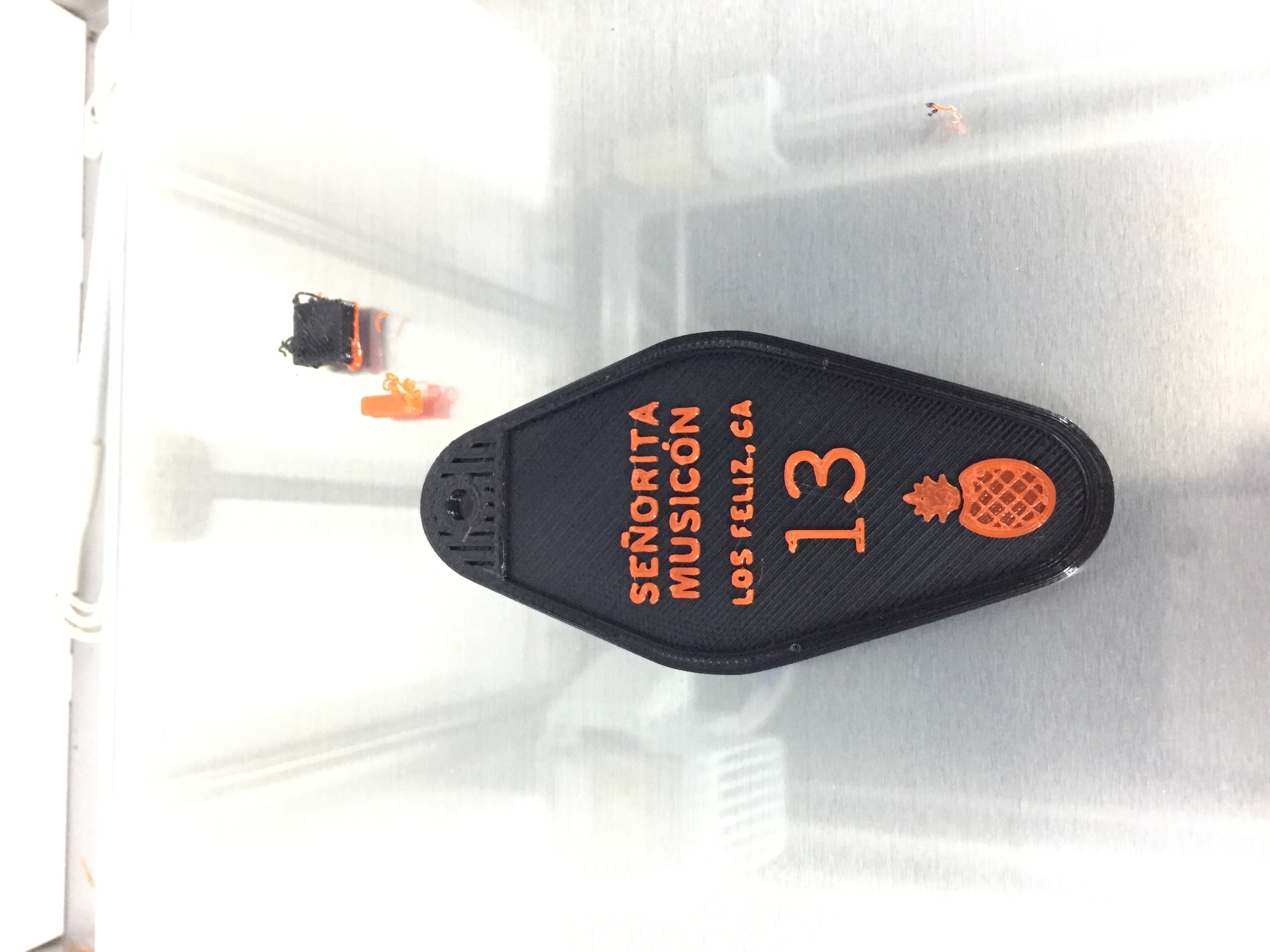

Today finished adjusting s3d new extruders and new cores. All working perfectly to make the stuff I need.
Print is done using very cheap BQ filament (bad size dia filament but sticks always good).
Also i think my esteps are off by 0.5%. But this bondtech cheap kit reusing the um3(um2plus) feeders, works like a charm. I can push 70mm/s 0.2 layer at 205C. So pretty pretty nice vs 2.85
Fonts quality should be better but S3D has a small bug that doesn't allow me to wipe+retract when using dual.
