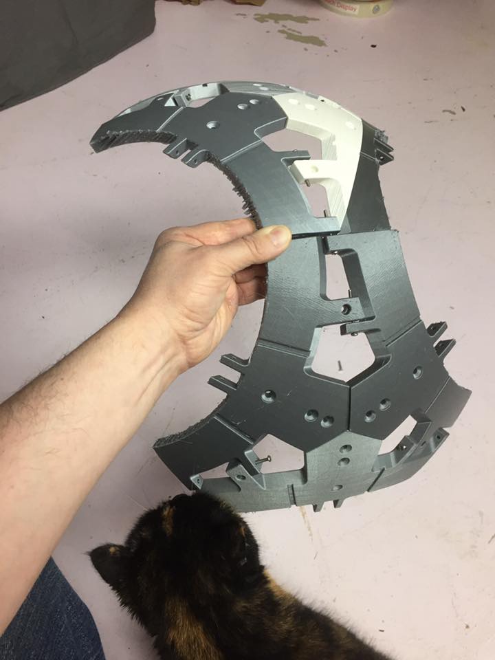

Here's the PLA test pieces I did a few weeks ago, assembled, showing a section of what the frame will look like (Momma Cat sniffing her approval)

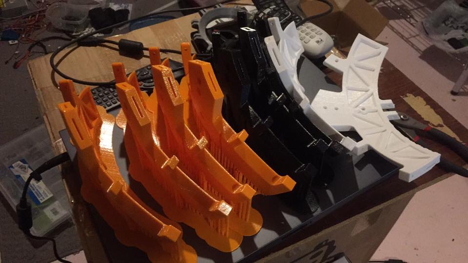

Here's 9 of the nGen pieces made up, using the stronger infill pattern (Triangle). 15 to go! (24 for a complete frame)
