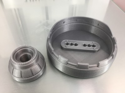

Piece on the right is the eye surround piece for BB-8 done at 0.10. Left is the holoprojector done at 0.06

Post by Izzy » December 1st, 2016, 3:15 am
I take it you have solved your underextrusion problem with the filament feedeing into the feeder now?

Post by LePaul » December 1st, 2016, 9:22 am
Well the feeder guide under the feeder is in place The other one fell off! Apparently the threads in the plastic weren't enough to hold it on.
I'll just get a longer machine screw, drill out the mount plug and use a nylon lock metal nut to hold it in place for good
But yes...no spool or filament jams And upper the retraction distance to 5mm made 99% of the hairs go away

Post by MTVDNA » December 1st, 2016, 12:44 pm
Those prints look very nice. The layers in the holoprojector are barely visible.

MTVDNA wrote:Those prints look very nice. The layers in the holoprojector are barely visible.
My first try with 0.06 ever and very happy with it. Really pleased with nGen too
