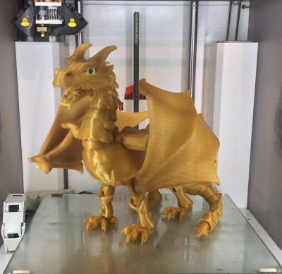

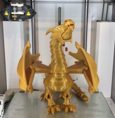

Now I've got the Bondtech feeder fitted and no hub jobs I managed to finish my printer guardian 'Braq', printed in Faberdashery Bling Bling Gold PLA.

Wow how many pieces was that?
Love the ducks on the fan shroud
Re: Show off My latest Print
Post by Izzy » August 30th, 2016, 2:14 pm
The movable Jaw version is 43 pieces, I had an inquiry for one on my Hub and I wanted to test the files as it was a nice model, I think I estimated about £60 but I need to check the files through the costings again as I wasn't happy with the quality of some of the courser models.
It was a nice model to build, I may do a scaled down version too. The design is from a great Spanish lady and is available on Thingiverse.
The Ducks are on my Fan Duct design, part of my "What Duck?" Design company :roll: :lol:

Would've loved to see a timelapse of that print :)

No time lapse as I didn't print it all at once, I split it in to several batches as I didn't want to have problems part way through a print and loose a lot of filament. I've had a lot of interest from friends that have seen it, and I'm thinking of building one at 1/2 scale just to see what it builds like as an option.
The wings are shown folded to the body but they extend out.

Did you paint the eyes? Stickers?
Post by Izzy » September 2nd, 2016, 4:49 pm
The eyes were printed in white then painted and held in with blue tack.
