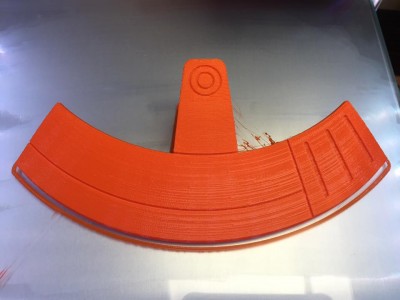

One of the first pieces for the external portion of BB-8...1/4 segment of the many rings that make up his body.
Being a curved object, this project will feature a LOT of support material :)
This print came out very good!
