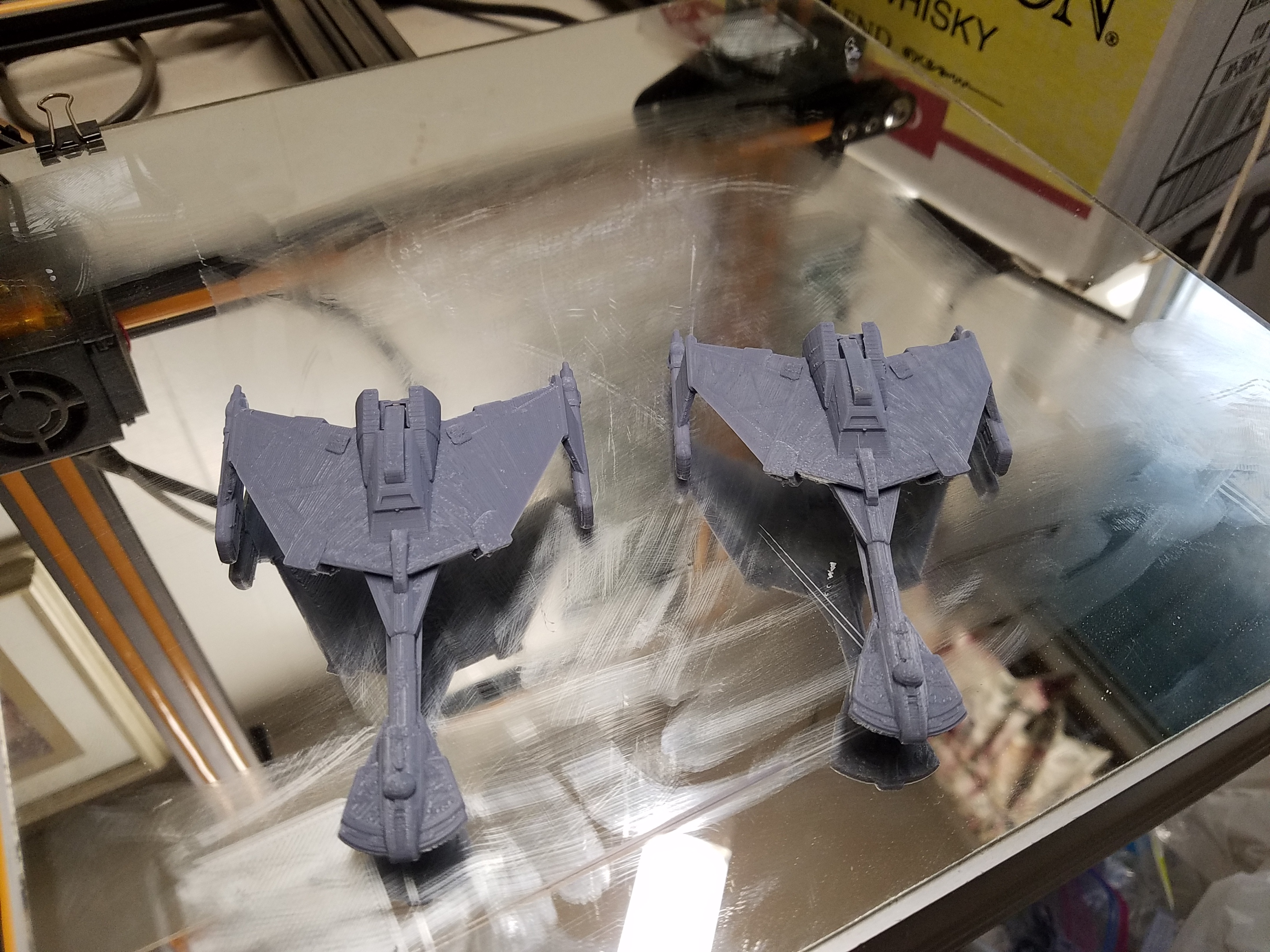

This print was very tough on my CR-10S. I can't share the STL here because I don't know the origin (commissioned off of Print a Thing). Both were printed with 0.1mm layer height. First one (right) at profile speed (60mm/s) using Cura 3.0.4 and supports, which were a beast to remove. The second (left) was printed with Cura 3.2 Beta using tree supports and print speed of 30mm/s.

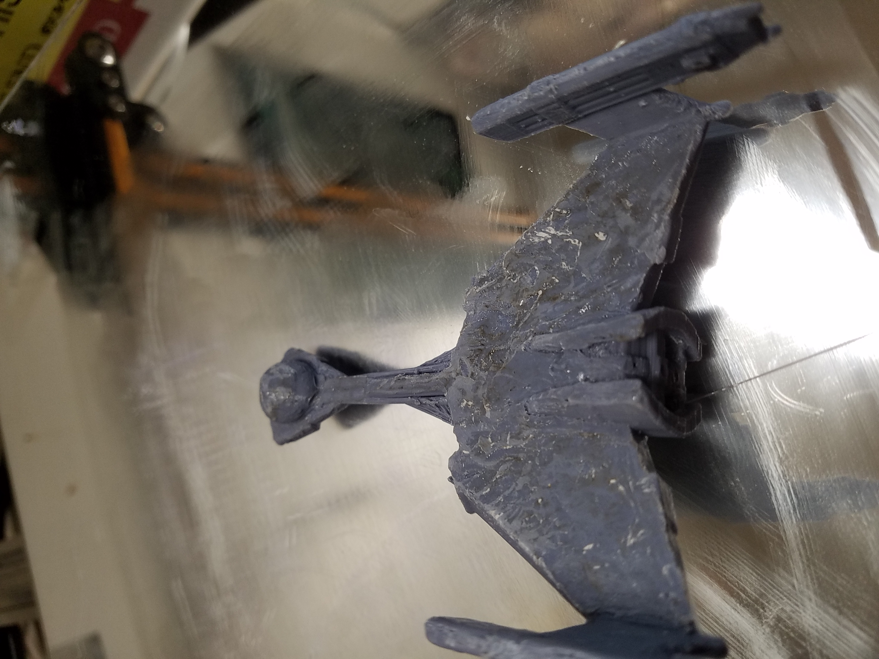

The bottom of the first one after breaking off the supports was so bad, I used my hot iron with a smoothing tip to clean it up (somewhat - still looks better than before).

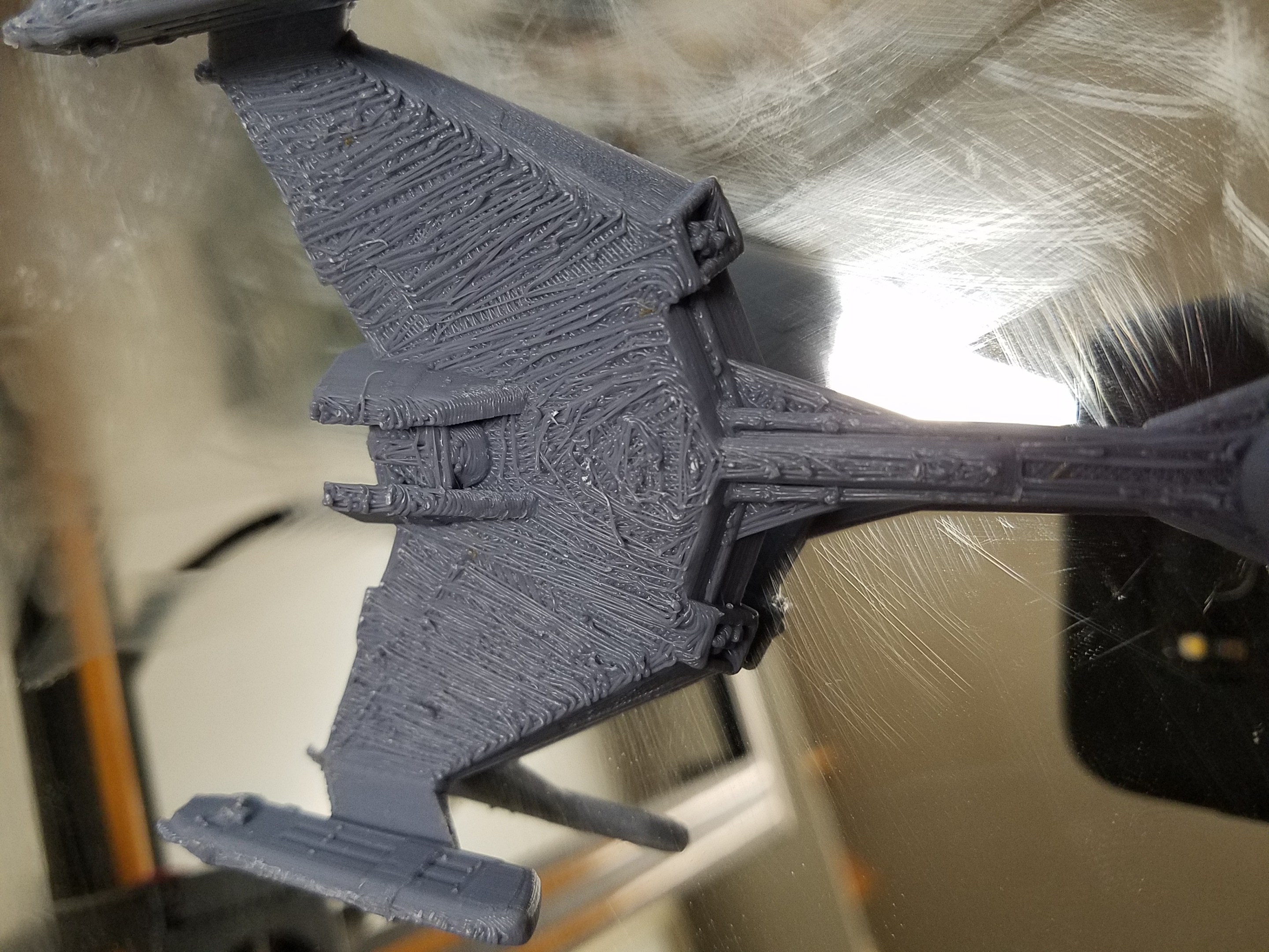

This one is the bottom of the 2nd print after removing the tree supports and a little scraping with an xacto knife. Note all of the lines. This is what I want to smooth out.
Suggestions would be greatly appreciated.

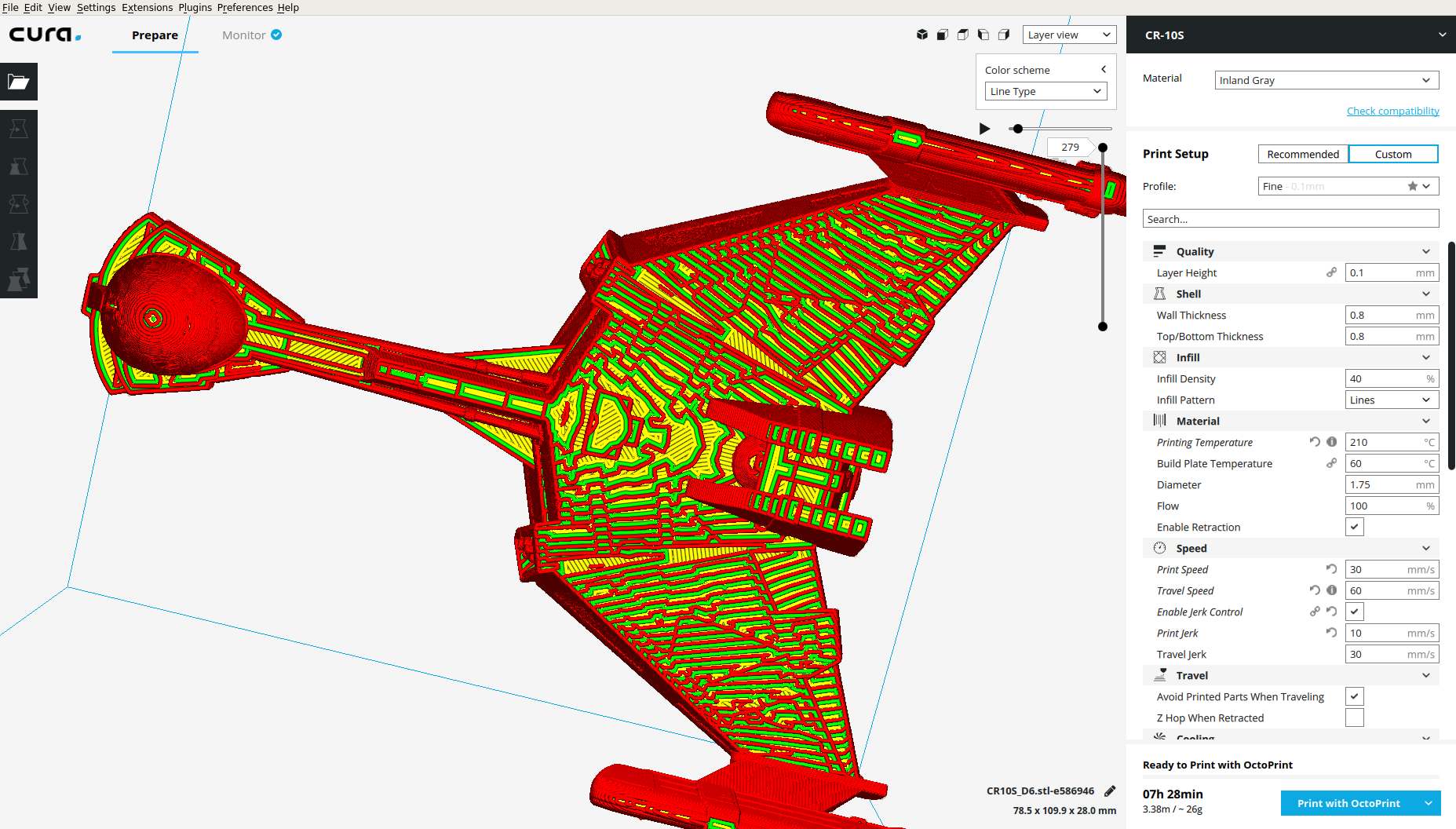

Looking at layer view, it looks like Cura is having issues with the underside.
I'll keep messing with it.

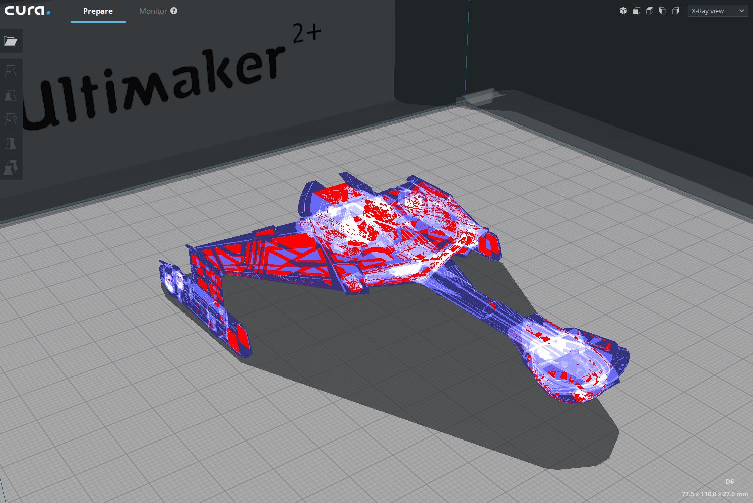

This is a Klingon D6 spaceship. I found a STL on thingiverse but the file is very bad according CURA 3.1 X-ray view.
If someone ask me, I do that...
