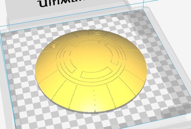

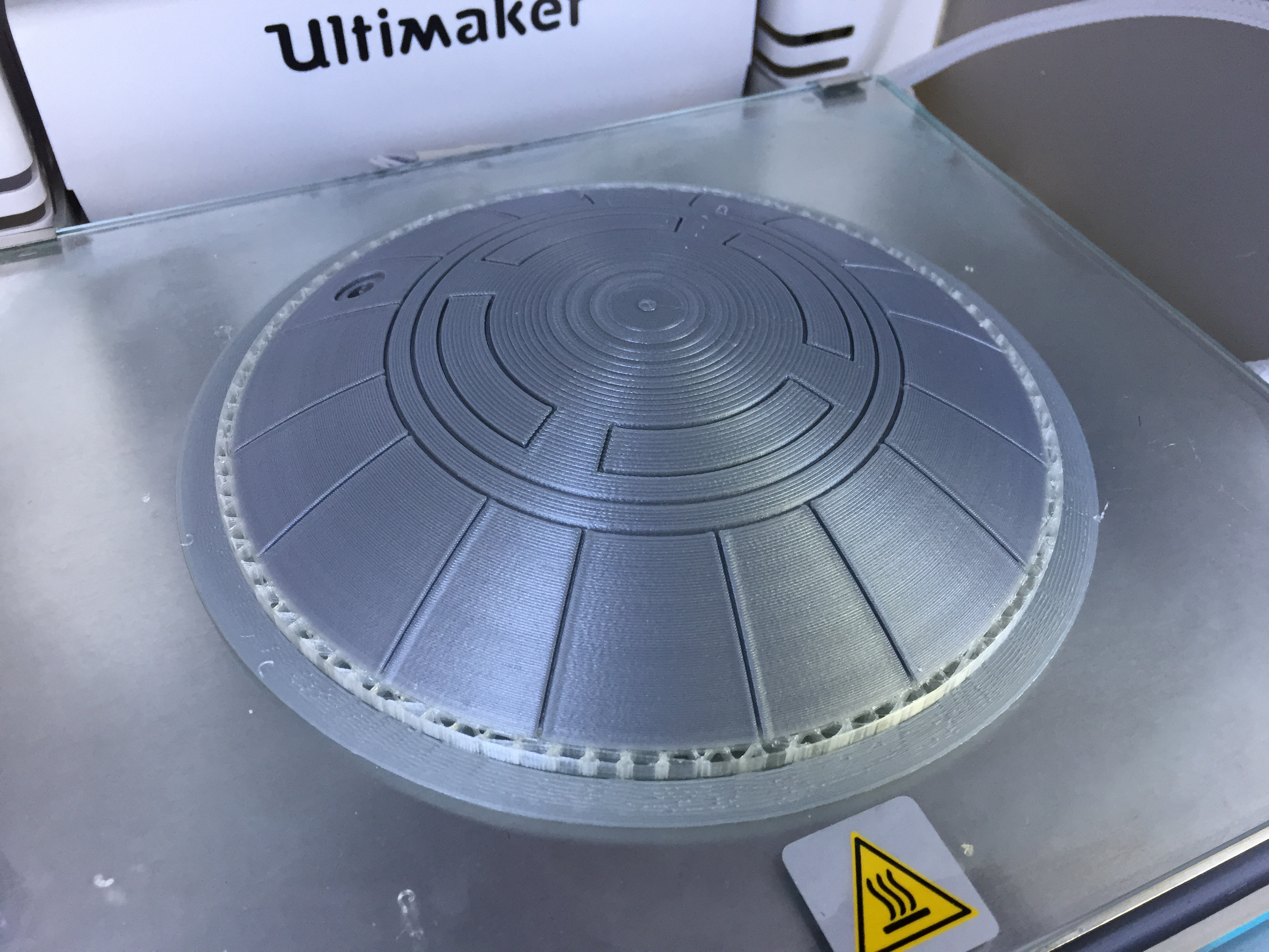

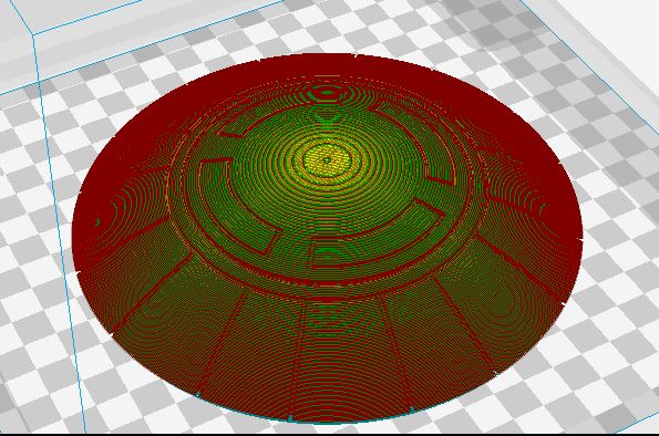

Post by LePaul » May 17th, 2017, 5:47 pm
Here's how the model started and how it shows up with rings

Post by Neotko » May 17th, 2017, 6:04 pm
Rotate 90, pva will do the rest

Re: Asides sanding...how to improve this?
Post by MTVDNA » May 17th, 2017, 6:42 pm
Or use thinner layers.
Post by shurik » May 18th, 2017, 3:53 am
In the cases like this, I take a deep breath and print at 0.05-0.06mm. Using ABS instead of PLA also improves the surface quality quite considerably for surfaces like this. You know all that stuff, don't you? :-)
Post by Xeno » May 18th, 2017, 6:56 am
The surface quality would stay the same with PLA or ABS, but ABS is soo much easy to sand then PLA :)
but you would need to enclose the UM for ABS.
you could try XT, this is also good to sand.
It also looks like you printed a little too hot ?
Post by Neotko » May 18th, 2017, 7:26 am
Corners with curves are a sign of low accel/jerk speed, my main concern about um3 profiles and machine.
Also.. doesn't look bad for a free printer.
Post by LePaul » May 18th, 2017, 8:25 am
Ha well it is nice to have the Ultimaker 3 for a month and see what it can do
90 degrees, had't thought of that
I currently have it printing 0.10 layers and will be done in 44 hours! But, it will be fun to compare 0.10 to 0.20!
