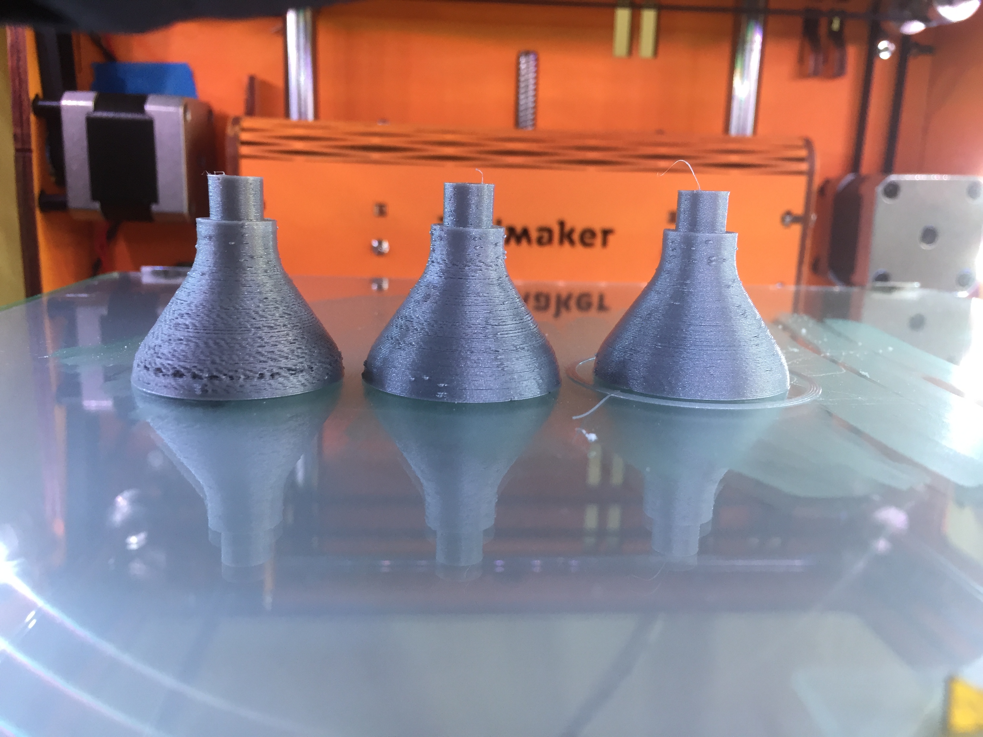

Post by LePaul » November 9th, 2016, 6:50 pm
Ultimaker Silver PLA
210, 220, 225. Maybe more fan at 225?

Post by Izzy » November 10th, 2016, 4:08 am
Try 230'C just to see if it is to high

Post by LePaul » November 10th, 2016, 8:06 am
I think I will up the retracting distance from 4.6 to 4.8 and see how that goes too

Post by Titus » November 13th, 2016, 5:12 am
For me this was solved using Ruby nozzle a dual fan(can't tell which did the trick as both were installed at the same time)

Post by LePaul » November 13th, 2016, 5:27 pm
Well the printer has the dual fan. Ultimaker PLA is a much different creature than the ColorFabb I have used almost exclusively in the past

I have a little bit of Colorfabb Dutch Orange and thought I'd print robots in each filament and see if both get blobs. Both do
I even checked the extruder Hobbes piece. It was clean but sometimes I notice nothing moves when I manually crank. Should I adjust that bolt tighter on the U-bracket/clamp piece?

Post by LePaul » November 14th, 2016, 9:14 am
Well I can see the filament moving in and out of that extruder drive very nicely. I removed the filament and took a small brush to the surface while slowly rotating it. No debris, so it isn't dirty.
I'm truly stumped! What's causing the blobs!

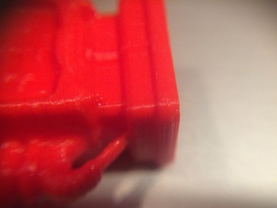

Post by Izzy » November 14th, 2016, 11:53 am
Two questions, what layer height are you using?
The photos attached are at 0.1mm (100um) layer heights. 210'C Nozzle,50'C bed at 45mm/s.
Material is Ultimaker PLA red.
And what are you using to photograph with, good quality images :-D
