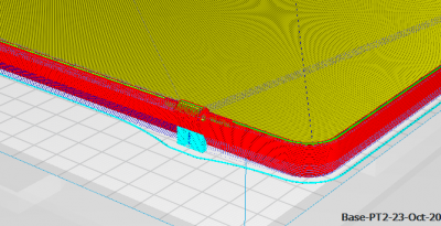

I have Cura 3.5.1 and 3.4.0
I am getting better results with Cura 3.4.0.
Print times:
Cura 3.5.1, 8hrs 44mins
Cura 3.4, 8hrs 41mins
Both have exactly the same settings.
Is anybody else getting different results?
Cura 3.5.1 See supports.
Cura 3.4.0 No supports

I did a few prints with 3.5.1 last night and I was paying more attention to the retraction settings (PETG...stringy stuff) than anything else.
I'm seeing both photos...one with and without supports...?

Yes that's correct. It shouldn't have supports as the angle is 60° and the software is set to 50°, it's a simple hinge.
3.5.1 says it need supports while 3.4 say it doesn't.
There is a small boss on the other side that does need supports.
Does that make sense?

I reported the problem to Cura and it appears there are a few people with the same problem, supports where they shouldn't be. One person had them on the top of there print!!
