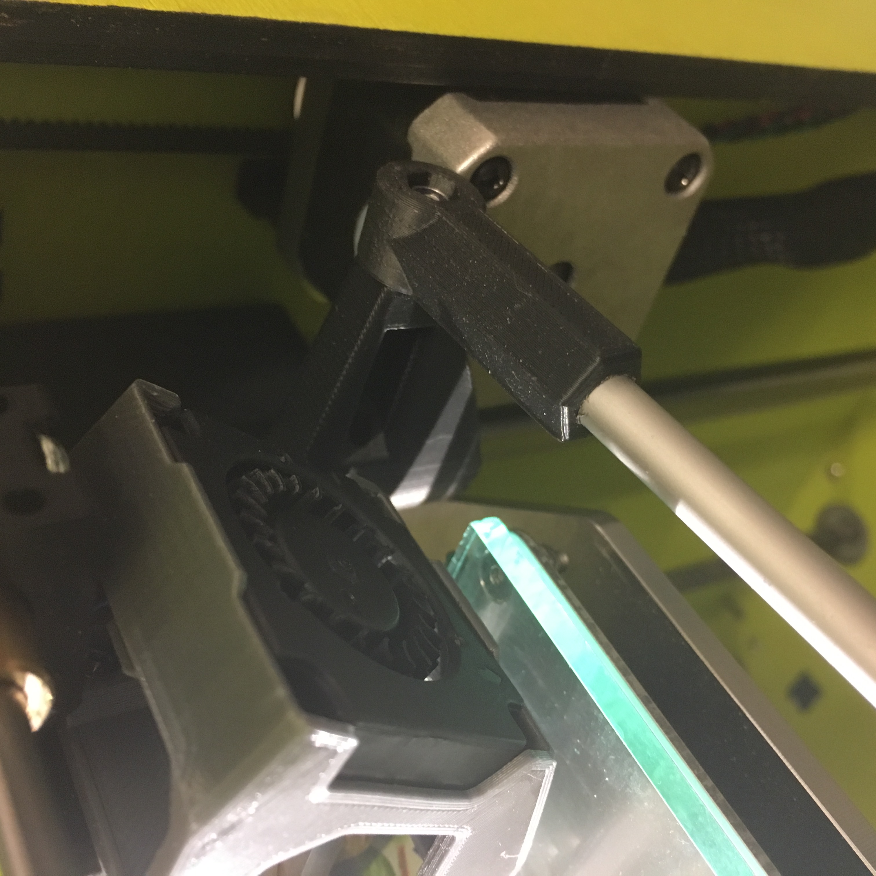

There's some imperfections on the fan top holder (this it's for um2 hotend on umo) because I actually forgot to measure the filament. It's a consistent 1.71-1.72 So I just changed the flow to 103 to balance the ratio. So far it's printing amazing, much better than ngen by a mile.
I'm testing 210-220C at 60-70mm/s 0.4 nozzle 60C bed with my windowwasher + one very very short puff of hairspray to clean the bed. So far, fan it's been at 160 (that it's like a 30% of normal fans) and there's no sign of any warping. I'm waiting for layer 193 when the big bridges start. But so far, amazing look/fell. And it's 100% bio, resist 110-120C and it's matte! Can't wait to start doing keychains with this color. Very promising.

Next test. One of my shop keychains. Without touching settings.
First top layer very neat.
Wow second top layer it's already gap-less...
It should do better overhangs. Since its cold temp it's higher, it gets faster to its glass state... M
