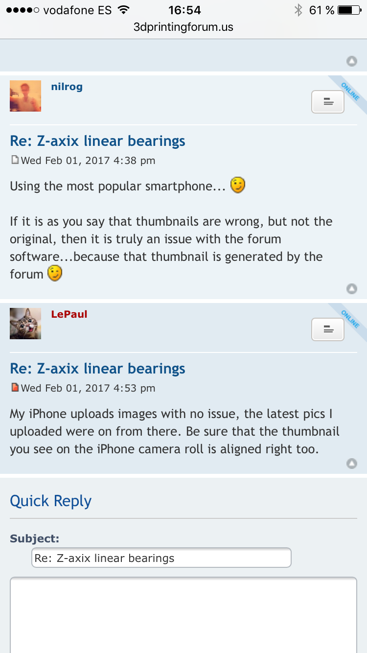

But I have to do it from my Mac due to the image-rotate issue with the forum software ;)

....which only you seem to have, for the record :)

Using the most popular smartphone... ;)
If it is as you say that thumbnails are wrong, but not the original, then it is truly an issue with the forum software...because that thumbnail is generated by the forum ;)

My iPhone uploads images with no issue, the latest pics I uploaded were on from there. Be sure that the thumbnail you see on the iPhone camera roll is aligned right too.
