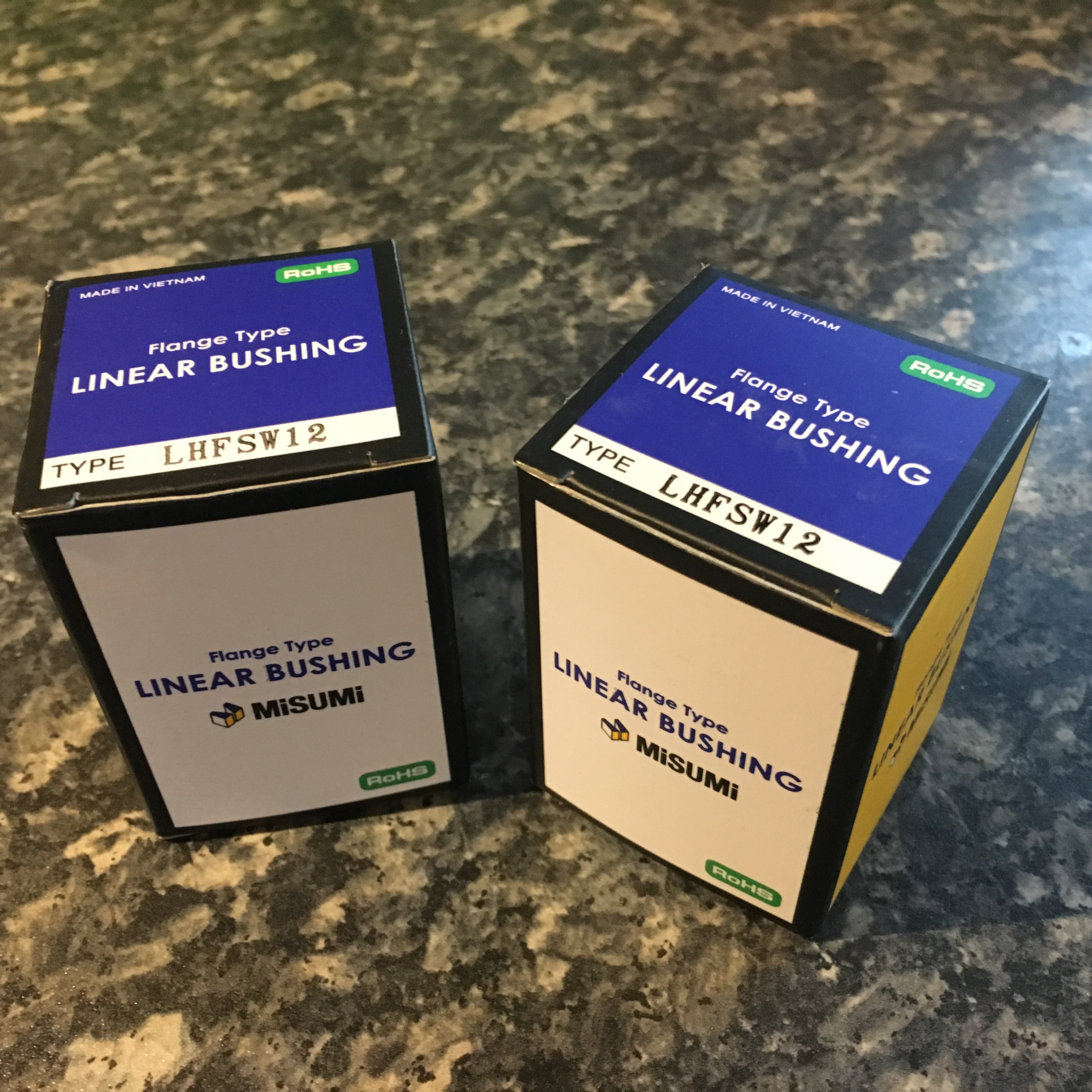

Re: Z-axix linear bearings
Post by nilrog » January 27th, 2017, 7:30 am
These are the ones that they sent.

Post by PeggyB » January 27th, 2017, 9:15 am
yes, those are the ones you need!

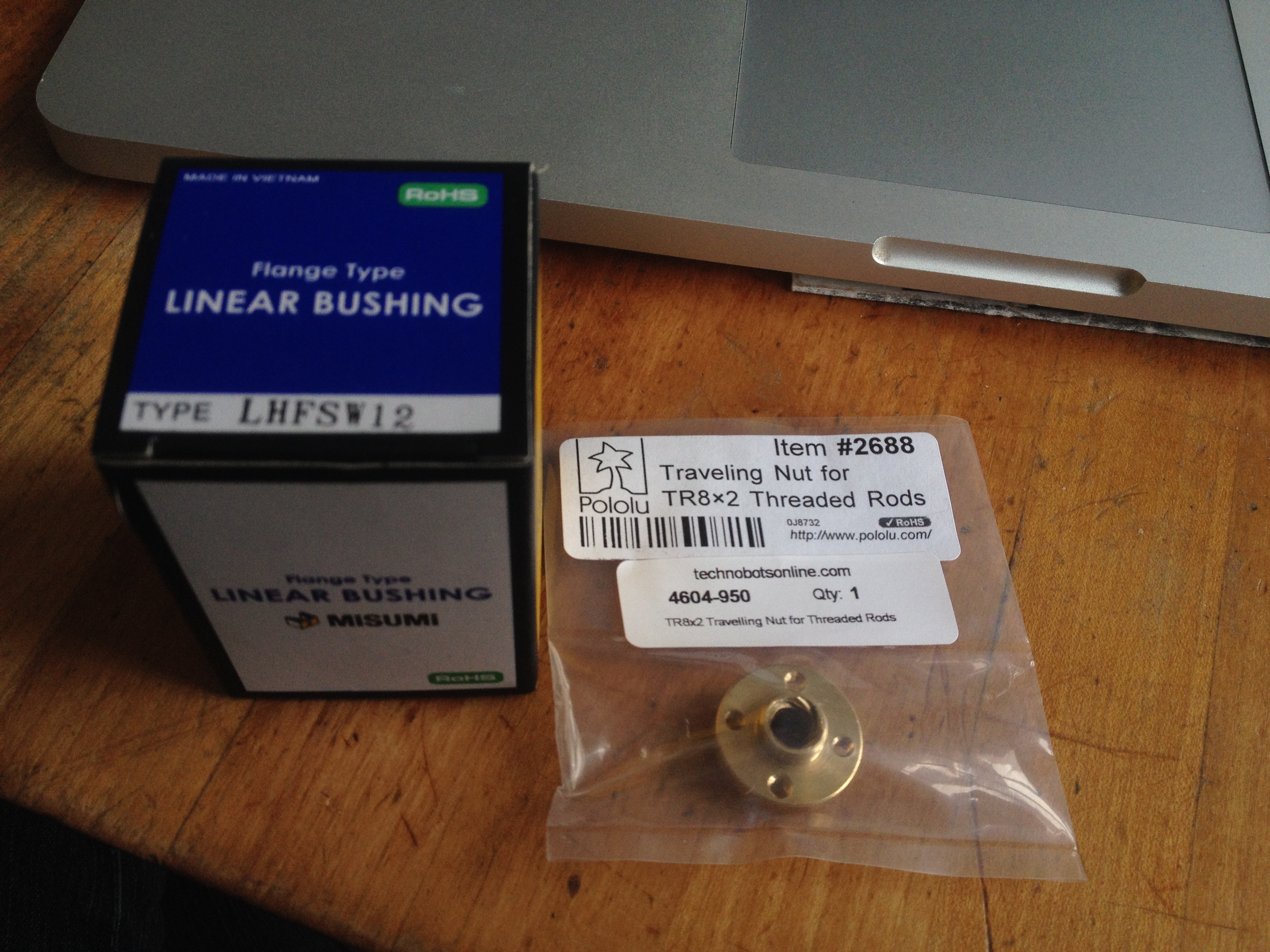

did this a year ago on my UM2go and Umo
