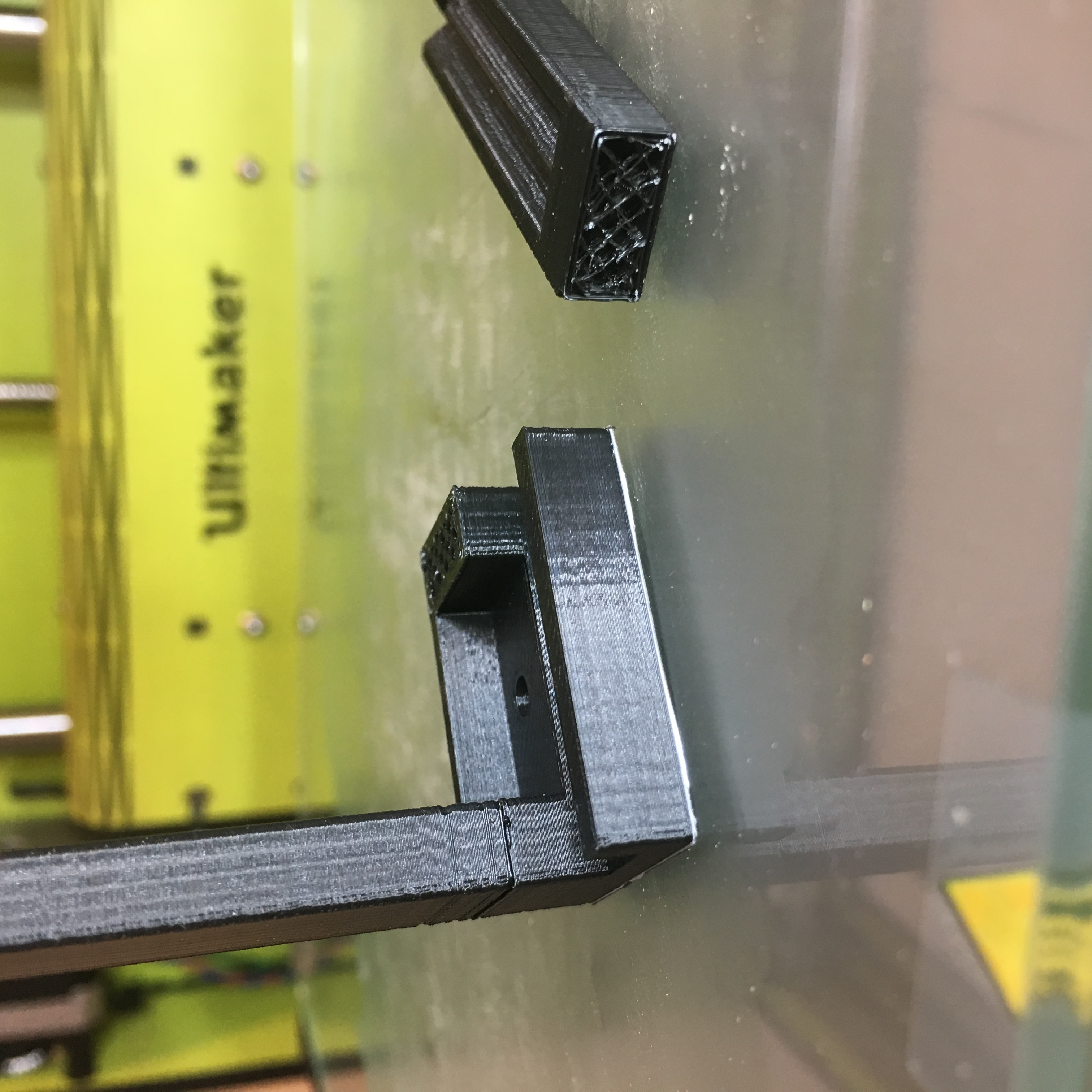

Here is another failed print. The first one after converting to GT2 belts. I did a fair share of movement and cleaning of the Z-axis but that did not help.
You can see the small irregularity on the one remaining pillar. The other one snapped of very easily. And that one you cannot easily break again so layer bonding is not an issue.
(there is something with this forum and images...it rotates them for some reason)

That could not be only with the Z but also an extruder issue

Post by nilrog » January 26th, 2017, 7:46 am
If this were an extruder issue it would happen in more places. This only happens on this particular level, and on all prints regardless of how they look. The print is perfect both below and above.

Post by nilrog » January 26th, 2017, 8:01 am
Again, all these parts are perfect.
But the bearings are not...at any place on the rods...if you move them up and then down (just as the bed does when you start printing) the friction increases greatly after ~10 mm.
I can print any part and unless a miracle happens you will see the same problem at the same level.
