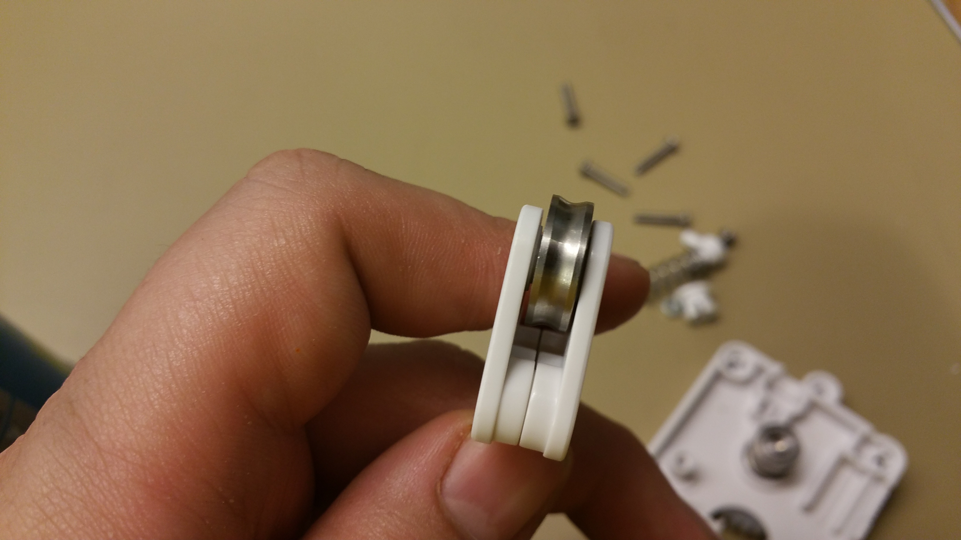

There is most definatly bearings with a semicircular groove rather than a V-groove, attached is for example the one in the UM2+ feeder.

Indeed, but that's for 3mm, if you use that for 1.75mm you get it flatten. I did some test with the um2+ feeder and I really don't like it much. But you have a point there, I wonder if scaled down bearings like that are rounded, the ones I got ain't good enough...

Neotko: http://www.ebay.com/itm/141938644240
These have 1mm radius = 2mm diameter, should be just fine for 1.75mm filament.
The UM2+ feeder might not be good for 1.75mm filament, but for 2.85mm filament, it really is good, i have had almost no problems at all with it since i first started testing one of the pre-production UM2+ units.
